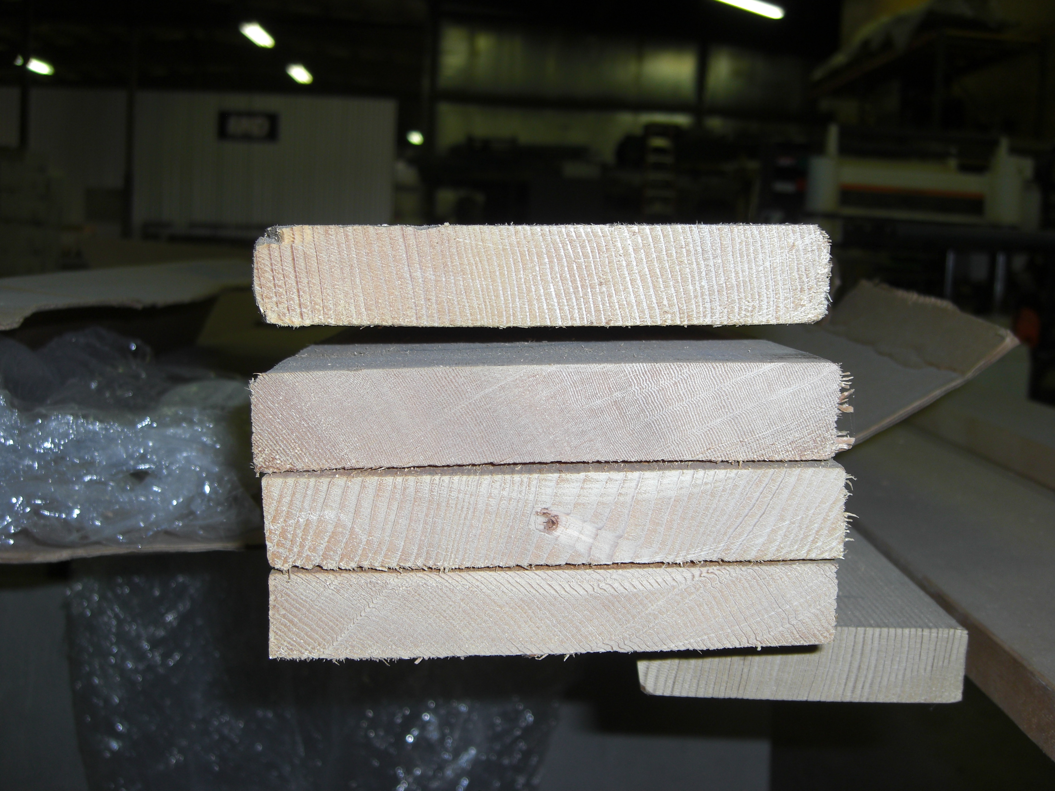

      As some of you may know from my HINT video on ribs, I have been buying my S
      itka spruce in bulk, in the rough and making my own cap strips. I have just
       placed an order with this same vendor, Public Lumber, and am getting my 4
      wing spars and the spars for the center section, cut to size except length,
       shipped to my door for about $150-$170 less the the other web based places
       I have looked at.- I am told I will have them in a day or two!
      I will follow up with a quality and satisfaction email to the list once I h
      ave them and take a good look.

      Michael,
      Just out of curiosity, are you having them grade the wood according to
      aircraft standards for you before they ship it? If not, are you at all
      worried about buying the spruce sight unseen and hoping it meets aircraft
      specs?
      Ryan

      I have been pleased with the bulk spruce I have bought from them for my cap
       strips. They advertise their Spruce on the web as "Excellent quality, spar
      , instrument and aircraft quality Sitka Spruce."- Slightly concerned, yes
      . I will know more once I have them in hand. I have heard people ordering s
      pruce from other places have had their share of not-so-good pieces from tim
      e to time as well, so...I'll know for sure in a day or two. Worse case I en
      d up cutting it up for other plane parts or projects and re order from anot
      her place.

      I bought my spar material from public lumber also, it seems to be OK, but i wont
      know if it is excellent until i plane it to size. i attached a few pics
      1 x 6 x 14'
      http://forums.matronics.com/viewtopic.php?p=212287#212287
      http://forums.matronics.com//files/cimg0500_765.jpg
