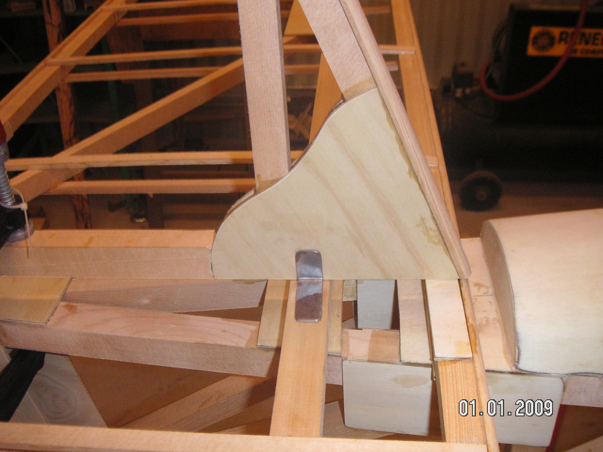

Message 5
| Subject:  | Re: Made a mistake |
      Hi Carson,
      I would just add a small block of spruce to fill the gap between the
      gussets.  It only needs to be long enough to give good edge distance on the
      bolt hole for the top bolt.  The only weight added will be a few grams of
      spruce and epoxy.
      Another thing to think about before bolting the fin in place is whether or
      not to provide an offset to counteract torque.  I put two sets of bolt holes
      in my stabilizer - one to make the fin right on the centerline, the other to
      shift the leading edge of the fin an inch to the left of the centerline.  I
      originally assembled it with the fin offset and have not changed it.  I wish
      I had made the holes such that it would be 1-1/2" off the centerline and
      that would be about right (I have a 65 Continental, it would be different
      and in the opposite direction if you have a Corvair).  I still have to hold
      just a bit of right rudder in cruise.
      Jack Phillips
      NX899JP
      Raleigh, NC
      -----Original Message-----
      [mailto:owner-pietenpol-list-server@matronics.com] On Behalf Of carson
      Sent: Wednesday, December 31, 2008 6:33 PM
      Subject: Pietenpol-List: Re: Made a mistake
      Thanks for the replies I was worried about adding extra weight down there do
      you guys think a small block would do or should i run it all the way up to
      the back of the leading edge.
      Here's some pic's
      Carson
      http://forums.matronics.com/viewtopic.php?p=222068#222068
      http://forums.matronics.com//files/pietenpol_052_612.jpg
      http://forums.matronics.com//files/pietenpol_051_119.jpg

              Gardiner,
              It seems that adding the cap strips would have taken 5 times
      longer to do than just rib stitching.
              And I assume that you didn't build the original Pietenpol wing?
               Cause the under side of the original wing is concave, and has
      to be rib stitched, as far as I know.
              Please clarify.
              thanks
              walt evans
              NX140DL
                ----- Original Message -----
                From: Gardiner Mason
                To: pietenpol-list@matronics.com
                Sent: Wednesday, December 31, 2008 3:37 PM
                Subject: Re: Pietenpol-List: inboard wing bracing
                Jack, I just covered my wings and did not have any trouble.
      Instead of rib lacing I ran 1/4 by 1/2 inch strip on top and bottom the
      full length of the wing between the spars. And between the rear spar and
      trailing edge I did the same. This keeps the rib from pulling in when
      shrinking. I,like Barry, did not read the plans and completely missed
      the braces as depicted. Cheers, Gardiner Mason
                  From: Jack T. Textor
                  Sent: Wednesday, December 31, 2008 2:37 PM
                  Subject: Pietenpol-List: inboard wing bracing
                  All, I need some help with the diagonal bracing for the root
      rib.  Barry has helped with some pictures, but I'm pretty lame.
      Regarding the bracing in the middle bay.I assume I need to brace the top
      and bottom of the rib.  The middle bay is pretty cluttered with
      compression struts and wires.  Has anyone braced the rib from the struts
      instead of the spar?  For the rear bay, can I just brace to the middle
      of the rib or should I go to the top and bottom?  That's about clear as
      mud!  Hope everyone has a safe and prosperous 2009!
                  Jack
