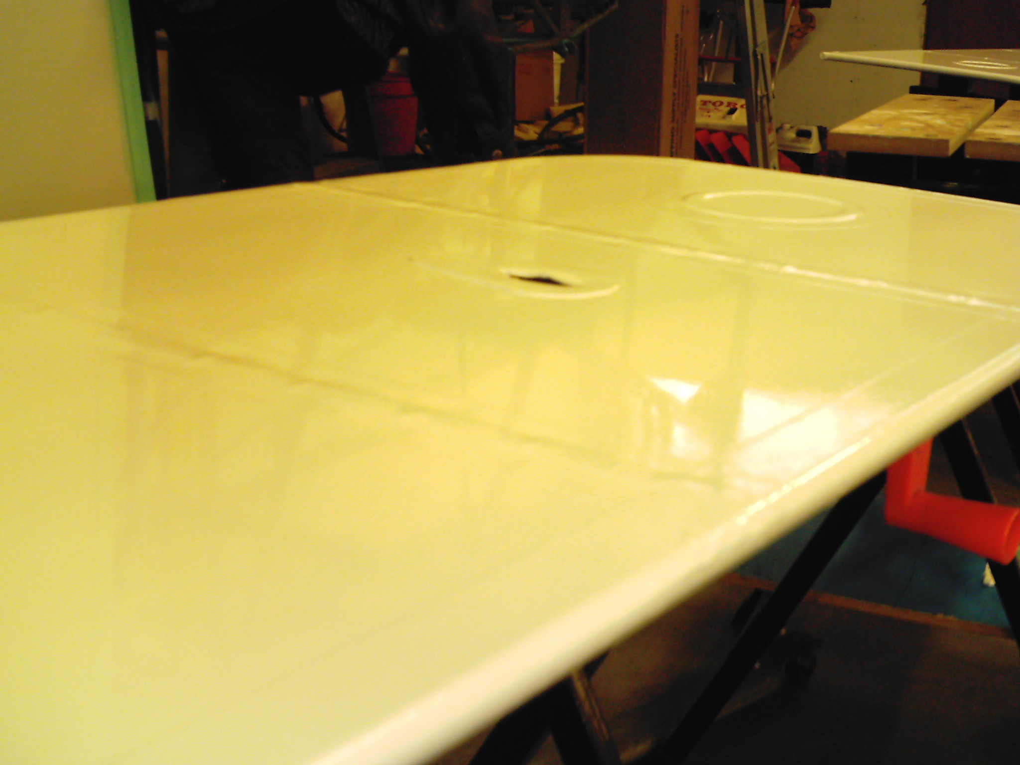

      Personally, I have had great results on fabric with Stewart Systems Polyurethane
      (in class, but it amazed me.. looked good) and good with Latex on my own, but
      have never been happy with the way anything I painted came out on metal, seems
      easy to get runs/sags or it looks great and then peels later. Those questions
      are great ones for a teacher when you take a class. Would highly recommend
      one of the three day classes. Did the Stewart Systems one in Cashmere, WA.. fun,
      scary adventure (blizzard in mountains when I went) and learned a lot.
      The pic on this is my little class project, but it came out very good. It is polyurethane.
