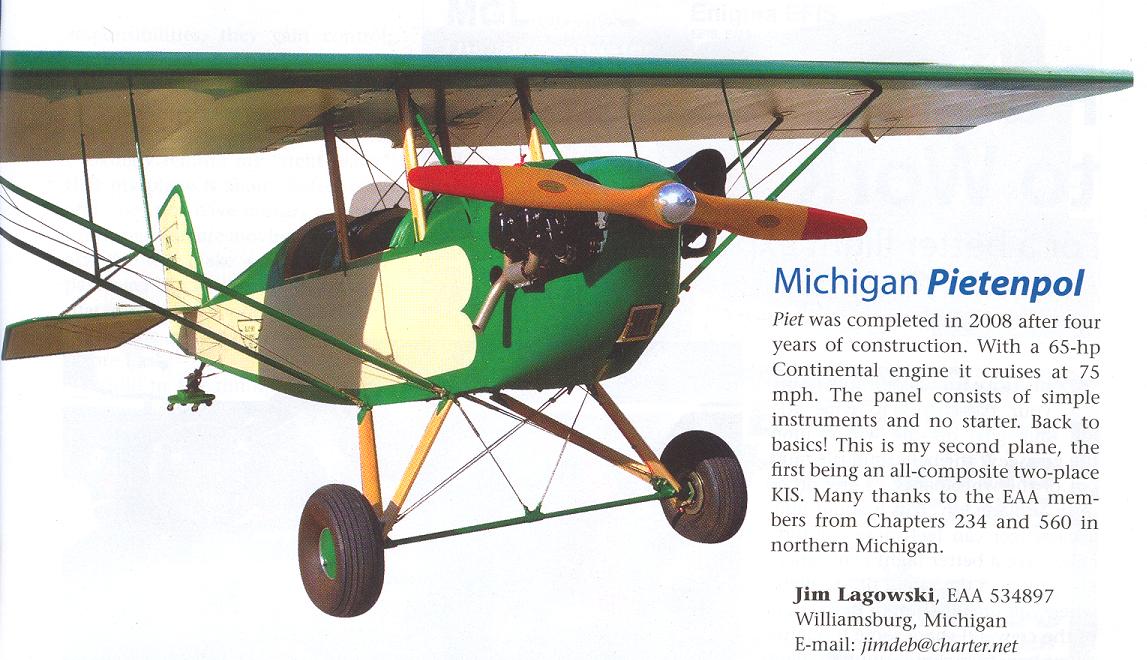

Yes, that's a pretty paint scheme and the wood color looks fantastic with the paint
colors. Cowling is nice too.
Is that a Fly Baby landing gear setup? Looks like it would be a bit lighter than
Jenny gear.
Glenn Thomas
N?????
