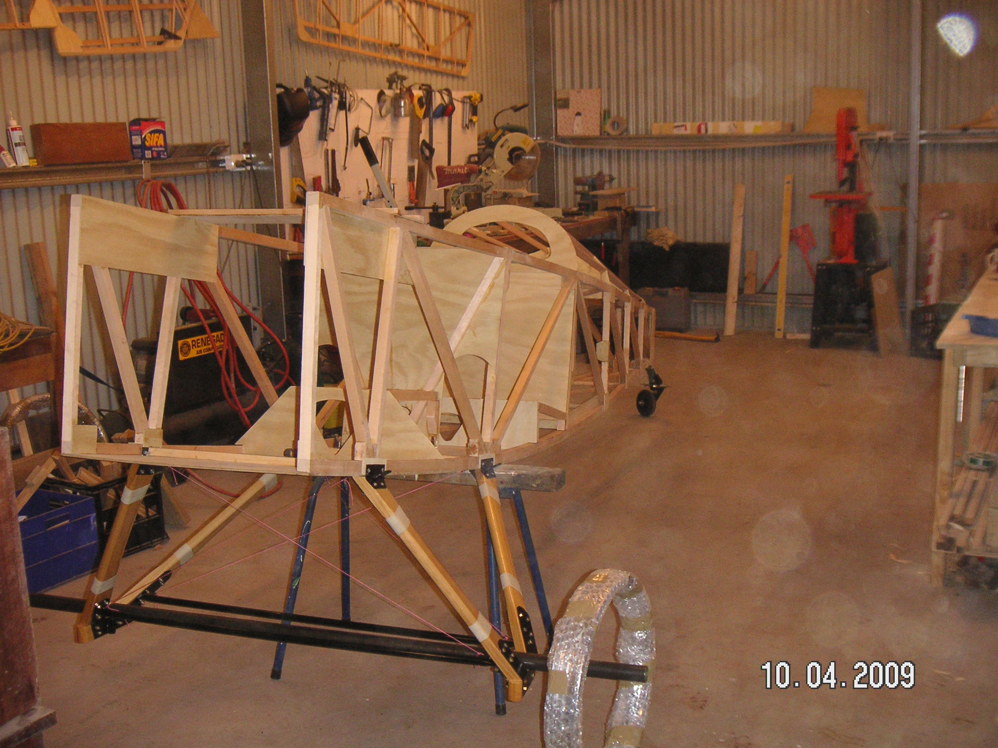

I just wanted to share with you all my gear progress and publicly
Thank Chris Tracy for all his help answering all my emails and his fantastic web
site,and also thank all the other people that answered my questions on the list.
Carson

Carson, excellent work there! I love those rims! Are they Lexan or
something? J/K. Actually the photos you posted were very helpful to me. I am not
building a Piet, but have been wondering how the straight axle set up works.
Does the axle simply "lay" in the "V" of the steel plate connecting the
wooden legs? I know the bungees go in there too, but I always wondered about
what attachments there was between the axle and the rest of that
structure....

Lookin' good, Carson. Congratulations - you've just finished the hardest
part of the entire project.

As far as I understand the axle just sits there in the vee I have put a piece of
pipe on the inside of the bracket to stop the axle from turning and will put
a safety cable incase the bungee fails,nothing new I'm just copying off others
before me.

I was considering a spring on the mount that would act as a shock absorber in lieu
of bungees. Not quite certain about the compression tension and spring size
that I will need which I suspect will be able to absorb 2gs upon touchdown under
harsh landing
Right now just ideas and considerations. I do expect to begin playing around with
the mock up to see how it all fits together

That's looking very nice! You and I are at very similar points. I like your
pink brace strings. Mine are going to be yellow. ;-)
