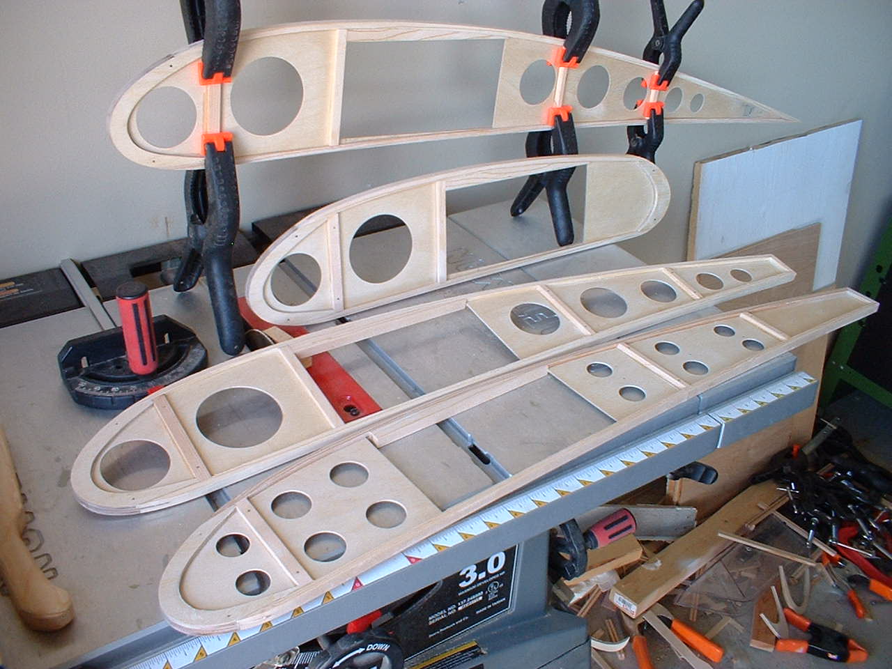

Message 4
| Subject: | Re: Materials List |
Hi Larry,
The ribs are a good place to be starting. ...lots of little pieces (I think I
had to make 960 gussets) with about 45 total pieces in each rib. Some of us didn't
use any nails, which Tony Bingelis also notes is acceptable in his book.
I found that while the jig took a little longer to make, making ribs with clamps
meant instead of using several nails in each of the 30 gussets per rib I
just lifted, turned and dropped the clamp and moved on to the next gusset. It
was pretty simple to make and I used that system on my empennage too, although
the time-savings paid off more in the rib building since you're making quite
a few of the same part. Used 1/4" carriage bolts, wingnuts and paint sticks.
The clamps were easy to uproot and reuse to make other parts as well. There
are a few of this who have used a variation of this method. Also, no nails
to remove when done. Here's a few pictures to give you some more ideas.
http://www.flyingwood.com/index.asp?page=21&filter=0
http://www.flyingwood.com/index.asp?page=4&filter=0
Have fun, this is a fantastic project and great community!
Glenn Thomas
N?????
http://forums.matronics.com/viewtopic.php?p=240437#240437

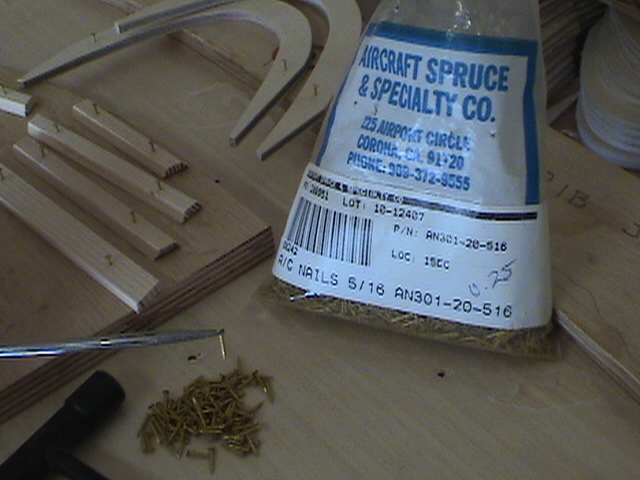

Message 8
Absolutely right Glenn, even though I considered the method you mention (no nails),
I totally forgot to mention it as a possibility.
I don't want to hijack the thread, but this may help Larry consider his options
too... how many nail guys actually pull them when the glue is set? I'm considering
leaving mine in. Is their any major disadvantage except the few ounces
of weight? Do they come loose and bounce around in the wing or something?
Glenn Thomas wrote:
> Some of us didn't use any nails, which Tony Bingelis also notes is acceptable
in his book.
Mark
http://forums.matronics.com/viewtopic.php?p=240478#240478
Message 9
why not just use 1/4 inch staples and a light weight staple gun. Its fast
and easy. The staples can then be easily pulled out with a small end nipper
type pliers. Thats the way I did it. I jigged up one rib and glued and
stapled one side. Pulled it from the form and added the gussets on the
other side. I then pulled the staples from the rib that was glued up the
day before. It usually took me less than an hour to glue up a complete rib
and remove the staples from another. On my best day I think I did four ribs
one Saturday afternoon.
Rick Schreiber
I left my nails in.... too much hassle to pull out, plus will damage wood.
Bought the "glue covered nails" from AC spruce.
Glue covered nails are not meant to be removed....
My 2 cents.....
Dave

Message 11
I'm using the glue covered nails too, so I guess I'll leave them in as well.
Great idea on the staples Rick.

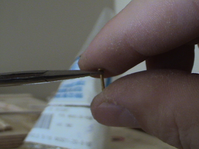

Message 21
Don't have the plans yet and don't know how it translates to fokker ribs, but you'd
just leave the nails in on the ones I built. Will "attempt to attach" photos..
if you can see nails in there.. Any thoughts on this for the piet?
What happened to the Fokker someone axed..er..asked? Too big a project and aint
as fun/cheap as a Piet. Fokkers belong at Rhinebeck. A piet seems to be more
realistic as a solo project and about a quarter or third the cost of a Tripe.
You should really have a team or couple folk building a full scale war replica,
(my humble opinion) as well as a few ground folk to help you fly it. The Piet
is more like the Champ I used to have. One can fly it on his/her own. Plus you
can give your kids, and later, grandkids a ride. I still have those ribs as
garage wall decor..
Atleast I have some practice with many a rib..
Larry
http://forums.matronics.com/viewtopic.php?p=240545#240545
