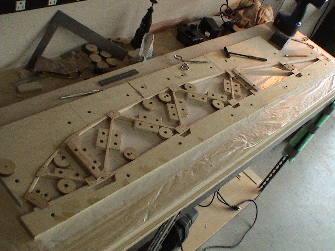

Did my second rib today. I tailored mine for the 3/4" spar as well. Looks like
I put my brass nails in same spot as you also (heh heh). As they say, Great minds
think alike..
Lar
