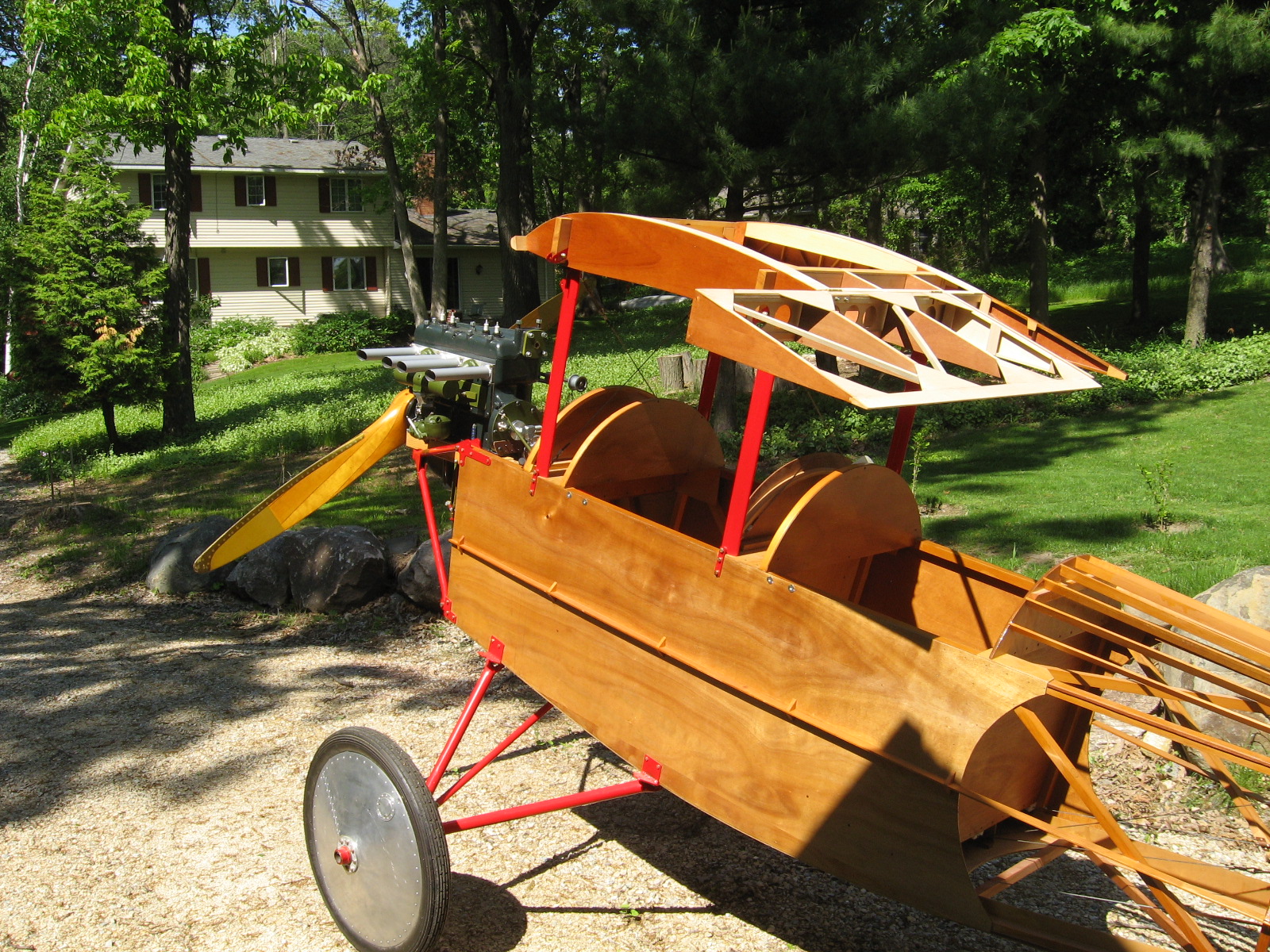

Message 10
      Corky,
      My fuse sides are 1/8" OKUME. Worked great!
      PAPA MIKE
      http://forums.matronics.com/viewtopic.php?p=250941#250941
      http://forums.matronics.com//files/img_1214_121.jpg

      OK, i have been a lurker on here for quite some time, allot of great information!
      I have been on an engine search for the last year, finally found one that seems
      to be a great fit. I personally wanted to stay with the nostalgic look of
      the inline  liquid cooled 4 cylinder, vs. the typical boxer aircraft/corvair
      engine. Over the past couple of months i have been converting my new engine for
      a dyno test to see if my calculations are correct, i attached a dyno sheet showing
      the result as well as some you tube clips. The engine is a Mitsubishi 2.6
      liter 4G54, widely used in forklifts, i chose this engine because of it low
      operating rpm and high torque. The engine weighs in at 244 lbs as shown. The
      engine in he test has thousands of hours on it, now it is time to rebuild it and
      i should get another 5-10 hp. Enjoy!

      here are some pics
      http://forums.matronics.com/viewtopic.php?p=250977#250977
      http://forums.matronics.com//files/cimg1224_114.jpg

| Subject:  | Re: Found My Engine!! |
      i have to try and figure out how to get my pictures smaller.
