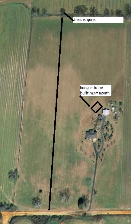

| Subject: | Re: original Pietenpol wing air foil |
Yes sir. I ordered 2-16 foot spars for my one piece wing. I will get about 31 feet
span. Reading everyone talk about poor climb. Thinking to make the ailerons
longer too. What y'all think? I will also use my O-235 Lycoming and suffer the
weight penalty. My runway is 1300 feet so I need my Piet to get with it on
takeoff. My hangar(40X50) is supposed to be built next month...sure hope so. I
need the room to build. The picture is from Google Earth. That area photograph
was taken 4 years ago during a severe drought. The grass died in some large
spots.
Jerry Dotson
