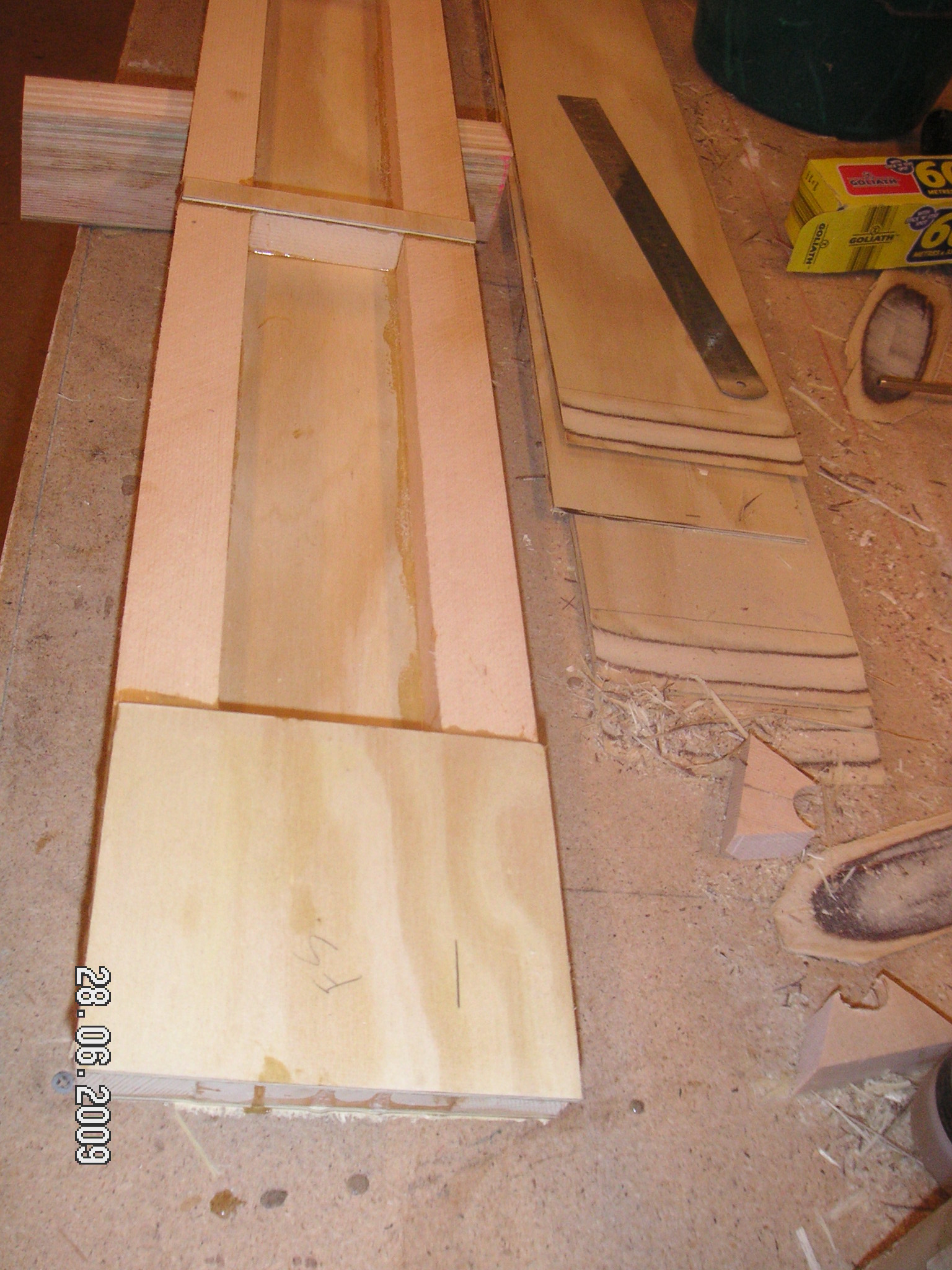

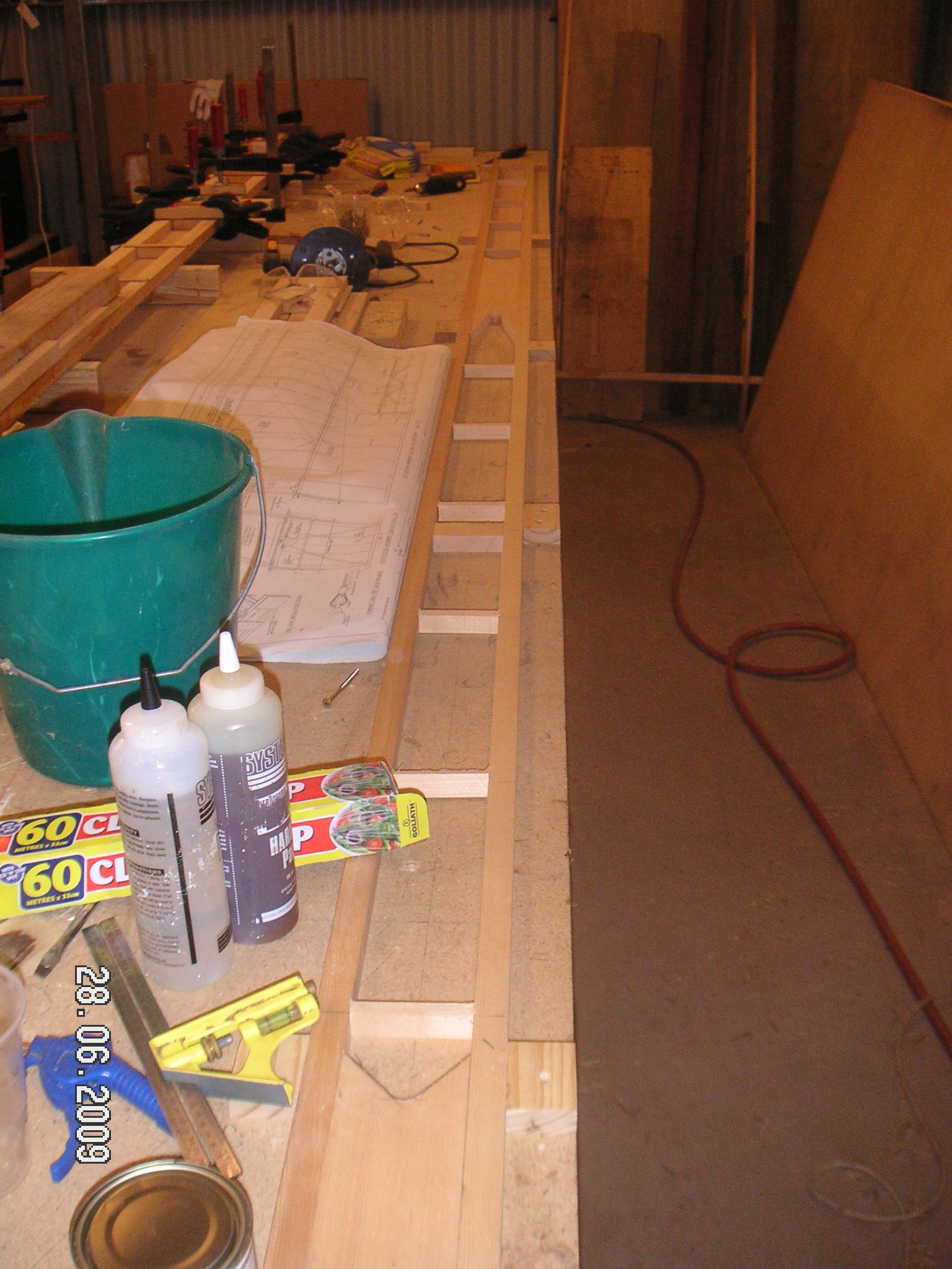

| Subject:  | UK built-up wing spar |
      Is the built-up (box) wing spar that is approved
      for use in the U.K. a 3/4" thick spar or 1"?  I've
      looked at pictures of one (Paul Shenton's, I believe)
      and can't see how it could possibly be 3/4".
      Oscar Zuniga
      Air Camper NX41CC
      San Antonio, TX
      mailto: taildrags@hotmail.com
      website at http://www.flysquirrel.net
Message 8
| Subject:  | Re: UK built-up wing spar |
      Oscar, I have looked at the built up spars as well, and it is hard to
      determine how they are constructed from photos.  I have searched for a place
      to order the PFA drawings for this spar, but all I have found is Mr.
      Trextor's drawings of his proposed spar.  It looks doable, but I'm
      interested in the necessity of intercostals where the ribs attach, filler
      blocks where fittings attach, etc.  These things are just as important as
      the spanwise loads because that's how we hang the fuse from the wing,  :-)
      I did just find this, but I wonder if the spar drawings are available as a
      supplement to US builders?
      http://www.pietenpolclub.co.uk/#/modifications-data/4533829721

Message 11
      Over the years I as well as others have been unsuccessfully in getting
      the UK spar plans.  The person who designed the spar will not sell them
      to anyone in the U.S. due to liability concerns.
      Chris
      Sacramento, CA
      WestCoastPiet.com

      Oscar,
      I built the UK spar. Check out http://www.cpc-world.com Page 4 of the build
      photos.
      The front spar is 7/8", the rear is 3/4". Both are covered with 1/8" ply
      totally on the front of the spars and in part on the rear of the spars.
      I can give you some dimensions if you like.
      I understand, as already suggested, Jim Wills will not sell to the US for
      fear of litigation if some thing fails. I have put them to the test and they
      don't fail.....
      Cheers
      Peter
      Wonthaggi Australia
