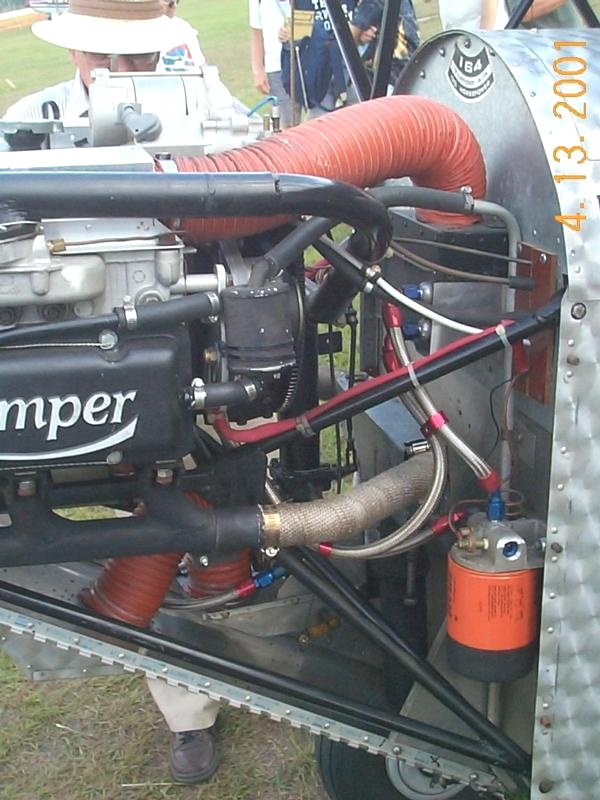

      You asked for *remote* oil cooler installations, right?  Here's what William Wynne
      had on his Piet.

      Mike,
      My Piet variant had a second Corvair oil cooler mounted to the firewall
      with a 2" SCAT tube run to it, in addition to the stock oil cooler on
      the engine. Never had an excessive oil temp with that set-up and it was
      easy to plumb.
      Darrel Jones
      Sonoma, CA

      Thanks Darrel.
       I think what I'm going to do is mount an oil cooler under the engine with an opening
      directing air into it.  This should work out to be above and forward of
      the carb air inlet.  Peter Johnson did something similar, but I will tuck mine
      further back so it's inside the cowling more.  I guess I won't know for sure
      how it will all work out until I get to work on the cowling.  That should happen
      in the next month or two.  I'll send pics when that starts to take shape.

      Mike,
      I used a standard Earls cooler. You may be able to get a longer, narrower
      one that will have the same area but less cowling intrusion.
      Cheers
      Peter
