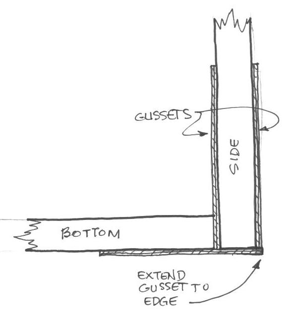

The sides are built first with gussets on both sides. When they are
stood up and the cross pieces installed, they butt up against the inside
gussets and are held in place by their own gussets. There is absolutely
nothing wrong with them butting against the gussets. You would gain
nothing by notching the gusset, and would instead weaken the gusset
which is what is holding the airplane together in the first place. The
butt joint is nothing, there is no strength there, you could probably
not even glue the butt joint, just the gussets.
There is a separate but related discussion going on here about
overlapping the gussets. It won't show up or make sense until you start
installing small strips between the gussets on the corners of the
longerons (for appearance sake as the fabric goes around the outside
corners of the longerons) but ONE of the gussets should extend out to
the outside edge of the other, doesn't matter if the side or bottom one
is it (I think easier to make bottom gusset extend), but if one of the
gussets doesn't extend over the other, you have an inside corner the
same thickness as the gussets to deal with when installing filler
strips.

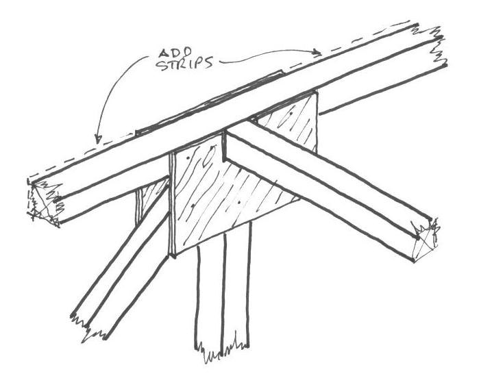

Message 2
| Subject: | Re: Fuselage Gussets |
OK Gene, I get your point about the butt joint being pretty much nothing for the
strength of the joint. So about the strips at the corners, see the sketches...
is this what you're talking about, to make smooth corners for the fabric to
wrap around the full length of the longerons, including at the framing member
joints?

Message 3
the drawings are exactly what I am referring to. I added strips to both
the side and top/bottom of the longerons to eliminate the edges of the
gussets from showing. 1/8" by 3/8" (or so) strips, not structural so
glued on with Elmer's woodworker's glue. Goes pretty fast.
Gene
