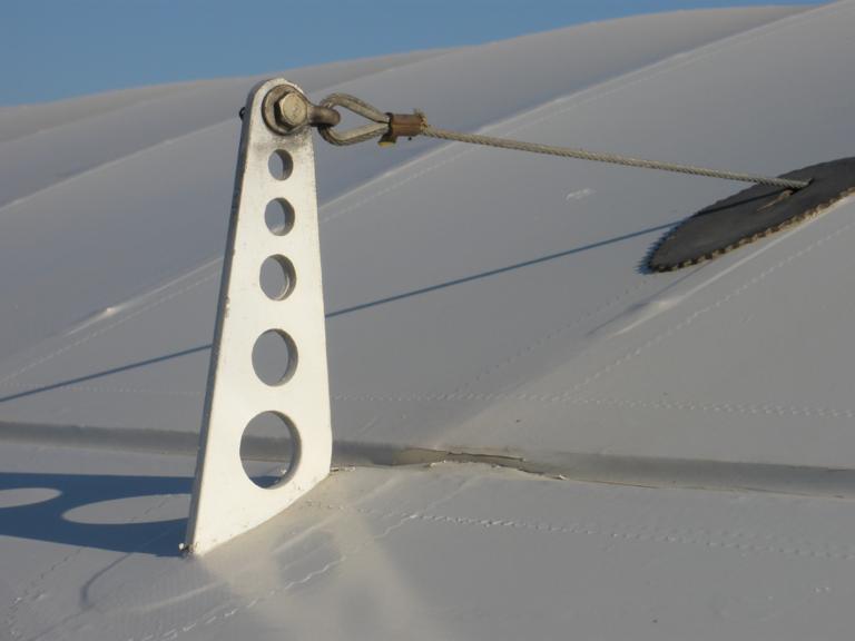

Message 18
How much is a difficult thing to guess, since the entire process is
uncontrolled. The temperature profile isn't known, and the time at those
temperatures is not known or even planned. The materials in the braze aren't
known, any more than the ways that stuff affects the base metal. MIL-HDBK-5,
the strength bible for metals, has a section on brazing that doesn't even
cover aluminum.
I'd say the actual strength doesn't matter. The Pietenpol builder generally
doesn't have a process to follow, a brazing oven where the process, if there
were one, can be controlled, and samples that he can evaluate
quantitatively. Whatever strength a particular joint achieves is unlikely to
be replicated at the next joint.
This is absolutely not suitable for flight controls!
It might be worth considering for fuel tanks, which can be pressure-tested
fairly easily - and ought to be, too.
David Paule
----- Original Message -----
From: "K5YAC" <hangar10@cox.net>
Sent: Monday, January 11, 2010 10:46 AM
Subject: Pietenpol-List: Re: HTS 2000
> Well, I'm not entirely sold, just curious. I did however talk to one of
> our machinists about this stuff. He agreed that this stuff is
> interesting, but that I would probably be changing the temper of the
> material in order to apply this stuff, then he opened his tool box and
> handed me a stick to try. I'll probably use some of my drop material to
> test this stuff.
> I understand what you are saying David... the bond may be strong, but the
> properties of the surrounding material may be changed. I guess that my
> next question would be... how much? Annealing is to make softer, not
> brittle, right? I'm just wondering if it would be so weak that the
> aluminum would fracture or bend or break before the hardware would be
> ripped out of the wood parts it is attached to. Actually, I suppose that
> is the big question. Maybe I can set up some tests to determine the
> strength of my material after applying this stuff.
> Mark - working on wings
> http://forums.matronics.com/viewtopic.php?p=281053#281053

Message 21
Mark,
I don't know anything about HTS 2000, but if you're thinking about welding aluminum,
and making your control horns of solid aluminum, refer to this post I made
to the list July 24, 2008 (food for thought):
Posted: Thu Jul 24, 2008 8:21 am Post subject: Aluminum in place of metal fittings
Mike,
In general, if you plan to substitute materials from those shown in the plans,
you had better know what you are doing.
For instance, with regards to substituting aluminum plate for the control horns,
you should be aware (maybe you are already) that if you weld aluminum, many
alloys are severely weakened at the weld location (for 6061 the reduction is about
40% within one inch of the weld).
Aluminum also does have a fatigue limit, unlike steel. What this basically means
is that steel will not be affected by fatigue (repeated cycles of tension and
compression) unless it is stressed above a certain level, whereas aluminum will
feel the effects of fatigue at any level of stress. Eventually, the aluminum
could develop cracks due to fatigue.
Also, the solid aluminum control horns will definitely end up heavier than the
hollow, formed sheet metal horns shown in the drawings. As an example, the aileron
control horn has a surface area of approximately 19 square inches on one
side. Two thicknesses of 22ga (.03") mild steel (or 4130) will weigh about 0.33
lb. One thickness of 3/8" aluminum will weigh approximately 0.7 lb - or twice
as much. Of course, you could machine the aluminum into a bit of an airfoil
shape, which would save a few ounces. But then you will still need to add bracing
angles and nuts and bolts to mount this solid aluminum horn. Attached is a
photo of such an aluminum aileron horn (by someone else), which was cut from
1/4" aluminum plate. I would estimate that this whole arrangement weighs approximately
2 to 3 times as much as a plans-built control horn.
So, in conclusion, just make sure you do your homework before you start changing
from the plans.
Bill C.
http://forums.matronics.com/viewtopic.php?p=281102#281102

Message 24
Thanks guys, I do appreciate your advice. I had never heard of HTS 2000 or any
of the other aluminum brazing rods until today. I just found it interesting
that it seems to be so strong.
As for the aluminum control horns I really havent done any serious analysis or
destructive testing to confirm that 6061 will stand up to the same stresses that
formed sheet metal will. I do know that 6061-T6 claims to have a tensile strength
of 42,000psi and a yield strength of 35,000psi. Hardly the characteristics
of 4130 steel, but much more than my 1/2 spruce aileron spars would allow.
I really didnt think about the annealing that would take place during the
heating of this material. I know that welding aluminum is acceptable, but not
in structural assemblies. I suppose TIG is the most effective and least harmful
method (to the material), but oxy-acetylene is supposed to be acceptable too,
although it would distribute even more heat over a wider area. Again, I understand
this to mean non-structural assemblies like fuel tanks, cowlings, etc.,
as even TIG welding will soften the welded area to 6061-O (tensile 18,000psi,
yield 8,000psi). Ive also read that the assembly could be heat treated to
restore its strength. Im not certain about this but I guess Ill need to consider
that too if I want the full rated strength of T6.
Ive seen a couple of different aircraft that use aluminum control horns. One example
is on a Pietenpol that was built by a local EAA member. Ill pick his brain
as to how he affixed his tabs and dealt with annealing. Perhaps he did nothing
at all, or maybe he will enlighten me on his approach. I do know this
he has many hours on his airplane (his 5th) and is a well respected builder, even
in the Pietenpol community. Im not saying that as a dig at anyone, I am only
stating it to point out that I chose to duplicate some of his features because
I figured that he knew what he was doing (an assumption), and because they
look pretty cool. As for the weight of these items, I assume that you are comparing
1:1 dimensions for these materials. The example I studied has lightening
holes, which I also plan to implement. I know, I know there are probably
1000 arguments for or against the lightening holes too. Well, hopefully I can
provide some answers after my next discussion with this fellow.
Thanks again for the comments. They sure do help get the ideas flowing, and help
me formulate better questions when discussing these issues with others.
http://forums.matronics.com/viewtopic.php?p=281120#281120
