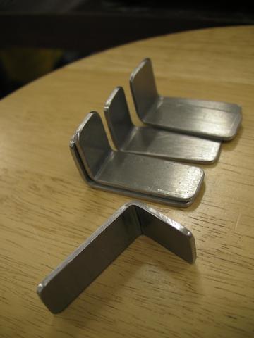

Message 4
      Hello All,
      Im bending the metal stabilizer attachment pieces using a small brake and getting
      good results. For my own piece of mind; should I have heated these when bending,
      or is cold bending (or the proper term) acceptable? I guess this applies
      to other pieces I will be making soon as well.
      Steve
      Southern Maryland
      http://forums.matronics.com/viewtopic.php?p=284587#284587

Message 6
      Hi Steve   They don't need to be heated but they should have a small radius
       to the bend to prevent cracking. Most metal brakes that I have used do not
       have a means of making a radius=2C they make a hard 90 degree bend which i
      s not good. If your brake doesn't make a hard bend then you're good to go.
      Ed G.
      > Subject: Pietenpol-List: Bending Metal
      > From: chase143@aol.com
      > Date: Tue=2C 2 Feb 2010 07:18:09 -0800
      > Hello All=2C
      > I=99m bending the metal stabilizer attachment pieces using a small
      brake and getting good results. For my own piece of mind=3B should I have h
      eated these when bending=2C or is cold bending (or the proper term) accepta
      ble? I guess this applies to other pieces I will be making soon as well.
      > Thanks=2C
      > Steve
      > Southern Maryland
      Hotmail: Trusted email with powerful SPAM protection.
Message 7
| Subject:  | Re: Bending Metal |
      Steve,
      To prevent cracking while bending the parts, make sure the bend radius is at least
      1 material thickness, and up to 3 thicknesses.  When I bend thin sheet materials
      (less than .25 thk.), I generally use 1.5 to 2 thicknesses as the bend
      radius.
      BTW, when you cut the pieces, make sure the grain of the metal is perpendicular
      to the bend line.  Bending parallel to the grain almost always causes cracking,
      and reduces the strength of the finished part.
      After bending, inspect with a loup to make sure no cracks have formed.  If there
      are any, discard the piece, and remake it, using a larger bend radius.
      Any pieces that are going to be flight critical, i.e., cabane, engine & strut fitting,
      landing gear brackets, etc., should have all edges sanded smooth (almost
      polished) after bending.  This will help prevent crack propogation from the
      edges of the piece.
      My company, KCS Development, is in the process of putting together a complete Pietenpol
      metal fitting kit, which will be manufactured using all of the above
      techniques, and more.
      Please feel free to contact me offline if I can be of assistance.
      Tom Kreiner
      Tom Kreiner
      http://forums.matronics.com/viewtopic.php?p=284606#284606
Message 8
      Ed,
      Good point on the bending brakes.
      Steve,
      I filed my backing bar to a 1/8=9D radius. If I need a larger
      radius I insert extra metal
      Gary Boothe

Message 9
      I found when squishing the ends of tubing for the rudder bar I would get cracks
      and poor looking ends when done cold.  Heating to red and using a piece of 0.090
      slipped into the end during the squish made a perfect looking end.
      If you dont already know Tony Bingelis has a series of good articles on making
      fittings. See Sport Aviation 9/1980, 10/1980 and 11/1980.  These are also reprinted
      in one of his books; I think its the one with the blue cover.
      Chris
      Sacramento, CA
      WestCoastPiet.com
      http://forums.matronics.com/viewtopic.php?p=284614#284614
Message 10
      Great ideas. I tried to use a rounded piece of flat stock, but never thought of
      just filing the backing bar! I love this forum.
      Picture of first pieces attached, but I will look at with a loupe!
      Thanks again,
      Steve
      http://forums.matronics.com/viewtopic.php?p=284615#284615
