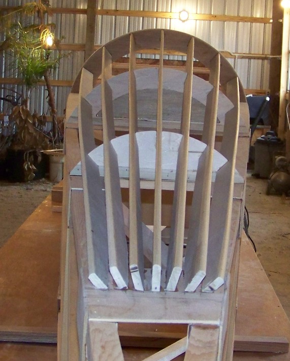

      Jack you and I are near the same stage of construction on the fuselage. Looking
      good. I did like you and fitted the bottom side. I'm not trying to steal your
      thread...just didn't want to start another.

      Yea Jerry don't be messing with my thread.  :)  I still have a lot of
      trimming and adjusting to do but it's nice to get the deck started.  If my
      IPod Google is correct you have a beautiful spread down there.  Looks like
      room for a great runway.  Next time we are heading down to Destin, we may
      have to stop by.  Do you have a website?

      >From pictures it looks like some leave their stringers square and other
      round out the tops.  I would appreciate thoughts on the best way to go so
      the fabric will look pleasing.

      Hello Jack,
      I am another "rounding person" (have not covered yet) based on several recommendations,
      and looking at completed versions. Also, I asked for a recommendation
      fro the instructor when taking the Poly-fiber covering class, and they recommended
      rounding, as a general rule, whenever possible. Just another opinion.

      Jack I rounded because I don't plan on taping them before covering. If you choose
      to leave them with sharp corners I would for sure tape over them.
      Jerry Dotson

      Pretty sure the edges should be sanded slightly, at least. After that, and
      with all the reinforcing tapes, I doubt whether one looks better than
      another.and ALL look fantastic at 75mph and 500agl.  JMO (Just My Opinion)
      Gary Boothe
