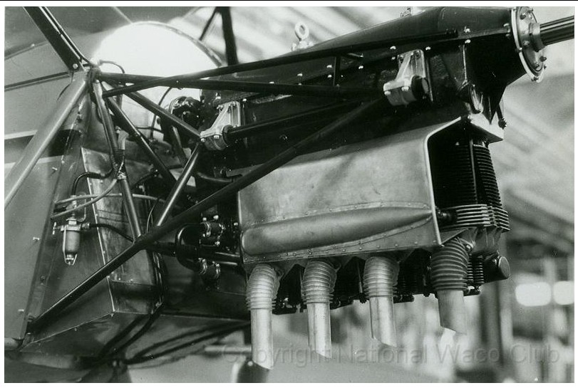

Steve Wittman had a 4 cylinder inverted Menasco on his race plane "Bonzo".
Jerry Dotson
59 Daniel Johnson Rd
Baker, FL 32531
Started building NX510JD July, 2009
Ribs and tailfeathers done
using Lycoming O-235
http://forums.matronics.com/viewtopic.php?p=290345#290345
http://forums.matronics.com//files/menasco_inverted_185.jpg
http://forums.matronics.com//files/steve_n_bonzo_692.jpg
