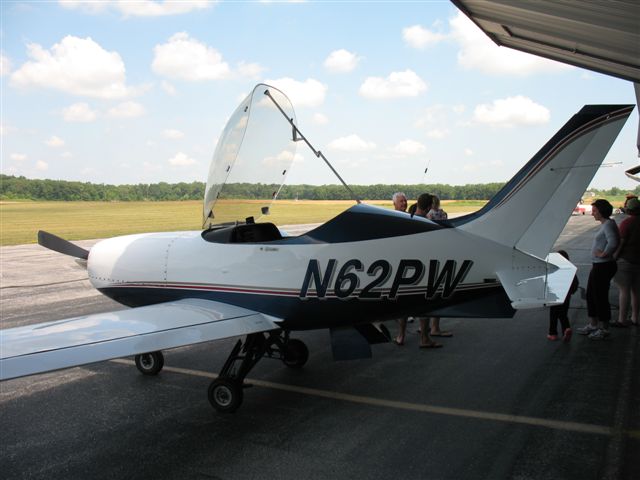

      Good Morning All - Just wanted to take a minute and introduce myself, as I will
      be spending time reading this list.  My name is Gary Wilson and as of now, I
      have not built an airplane, but helped my father build a Questair Venture.  It
      took him 20 years, but it turned out to be a beautiful bird (see pic).
      Now with a family of my own, we are just about ready to start our own "family"
      plane.  While walking through the affordable flying hangar at Oshkosh in 2008,
      I saw my first Piet, and have been fascinated ever since.  We have now settled
      on the Air Camper as our family plane, and plan to start construction in the
      fall.  Here is my plan of action so far to get us to the August time frame.
      1 - Join local EAA chapter and start attending regular meetings to develop a network
      of local builders.
      2 - Attend Brodhead - Take as many notes and pictures as I can!
      3 - Oshkosh - spend time in the woodworking tent and study engine options (especially
      William Wynne's Corvair option).
      4 - Order Plans
      As a first timer just getting started, I would certainly welcome any advice you
      might provide as I get started.  Also, if anyone is building or has a Pietenpol
      in the Greenville (Appleton) Wisconsin area, I would love to hear from you.
      I look forward to learning a lot from each of you!
      Gary
