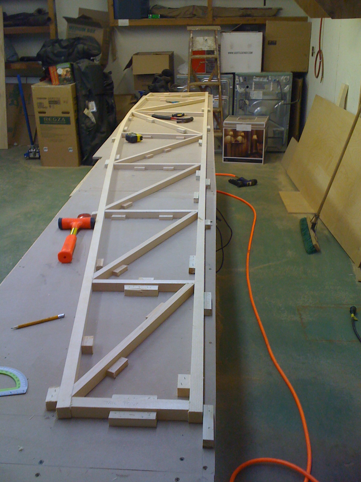

Hi Bill
I have done that glued on all the small gussets and left the sides open
Carson
http://forums.matronics.com/viewtopic.php?p=302344#302344
http://forums.matronics.com//files/peitenpol_093_345.jpg

Message 6
| Subject: | Re: gluing the fuselage |
I glued on all the small gussets while still in the jig. Unless you
make a jig for left and right, you really can't put the forward fuselage
skin on while in the jig. I can't really remember what I did here, but
it would be a good idea to have the inner gussets on the side without
the forward skin, just to help hold the shape.
BEn Charvet

Message 8
| Subject: | gluing the fuselage |
Like the others said, glue on all the gussets you can while it is in the
jig. You can leave off the side plywood until you finish the inside work.
It will stay together just fine. Mine was without the side plywood for
years. In this picture you can see I have the seats installed and still no
side plywood.
http://westcoastpiet.com/images/Chris%20Tracy/side_view_of_fuselage_3.jpg
Look at the pictures in the first three rows and you will see my fuselage
under construction
http://westcoastpiet.com/chris_tracy.htm
Also, consider not attaching the firewall plywood until your done with the
engine. Mine is just tacked on to help hold the fuselages shape.
Chris
Sacramento, Ca
Westcoastpiet.com
