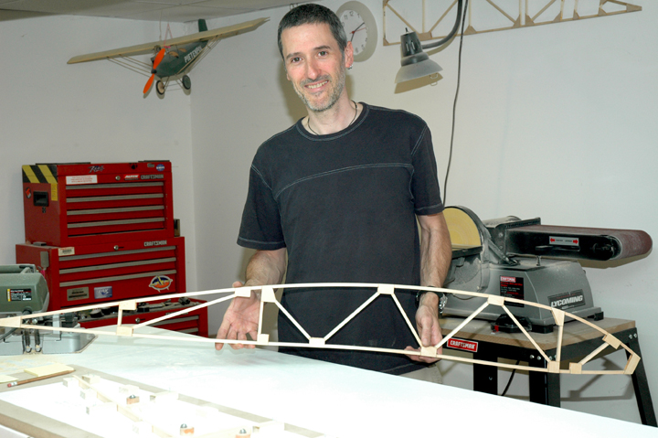

      in an effort to break up the monotony of little stick cutting- i decided to
      cut all the pieces for a complete rib and build one. only 29 more!
      after i finish cutting all those little plywood pieces!

      Earl,
      That is precisely how I completed my airplane. Just strive to complete the
       next piece, whatever it is. Whenever you can. Keep on plugging.

      And a real nice Pietenpol model hanging from the ceiling. The fun is just
      beginning.

      Earl,
      Or you could do like me, and stretch out the monotony of cutting little
      sticks for 2+ years!!!
