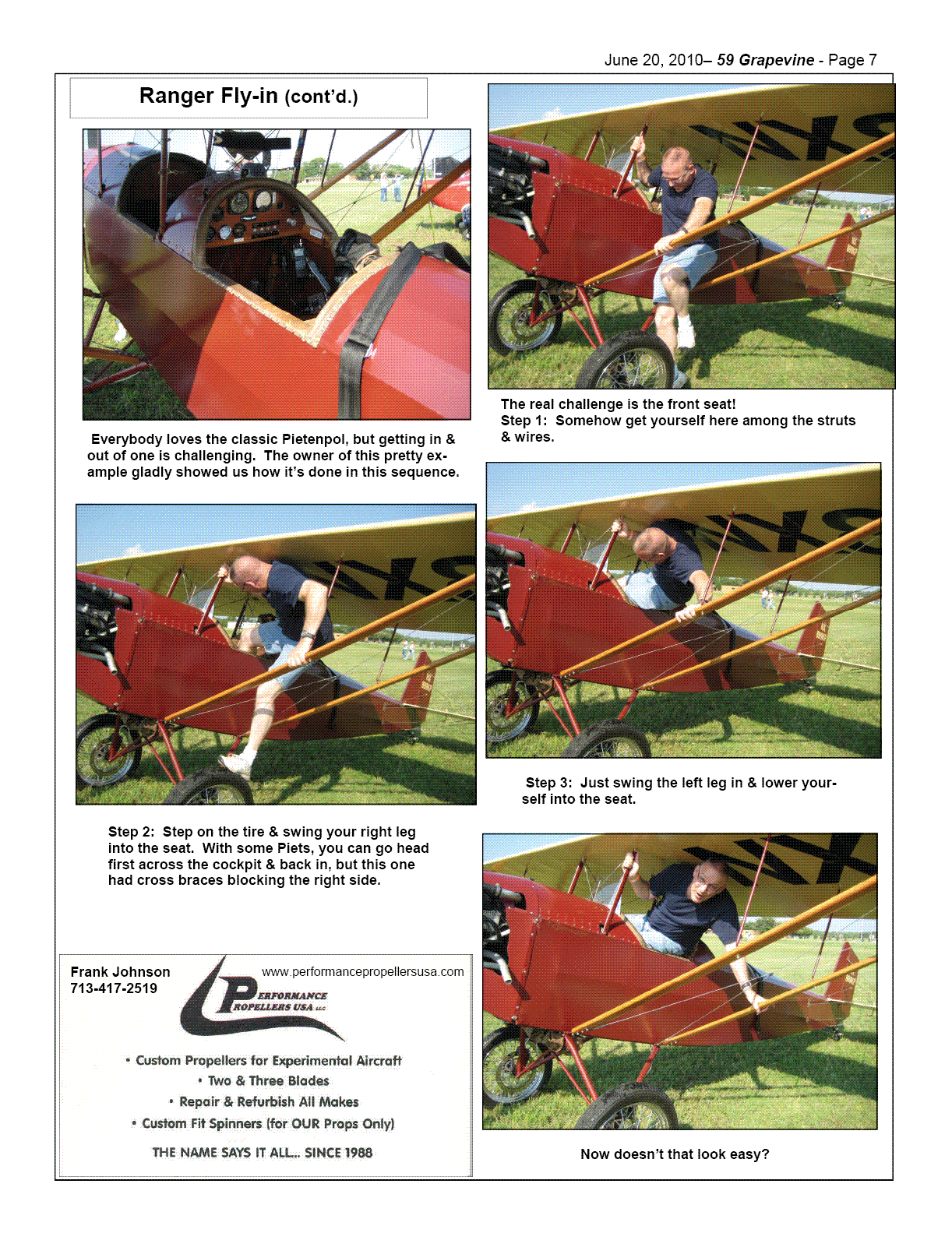

We went to a fly-in at Ranger, TX last month. Lots of fun. A couple of EAA 59
guys from Waco took some pictures of me getting in the front seat. The photos
made it into their newsletter. Proof that it can be done, for what it's worth.

Sorry. Learning about file sizes. Here it is, hopefully.
