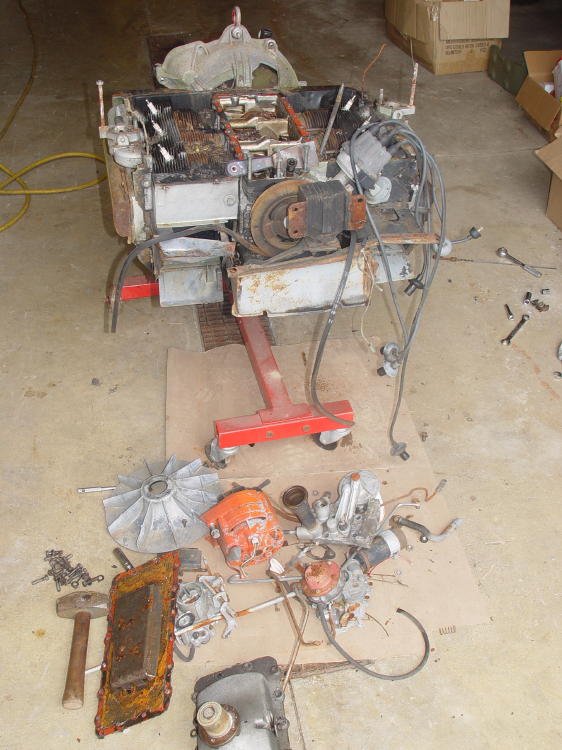

      More progress......so what do you think?
      John
      http://forums.matronics.com/viewtopic.php?p=308807#308807
      http://forums.matronics.com//files/crank2_709.jpg
      http://forums.matronics.com//files/crank_156.jpg

      You didn't try to turn the crank first, did you? Looks rusted up.

      Looks ready to snap...

      I walked away from this one because the crank didn't turn but WW told me to buy
      it anyhow.  For $125 he thought it was worth a shot.  Can it be cleaned up?

      Gotta get the heads off and the pistons out. If so, you stand a chance.
      Looks like you need a boatload of Kroil...or WD40...or mouse milk (or was
      that moose milk)...

      What? That's the way they're s'posed to look...

      Drained the oil and took the oil pan off.  I pulled the plugs and spun the engine
      360 degrees.  I found water in two cylinders.  I sprayed everything down with
      pb blaster and poured some marvel mystery oil into the cylinders.  I'll let
      that sit for a while and rotate the engine every few days
      at 90 degrees to get the oil all around.  I removed some of corrosion with a wire
      brush and found just some slight pitting on the cast parts.  I don't know how
      critical that is.  I've got plenty of time to break this engine loose and get
      it apart.

      I've got one of those rusty, no-crank-turning cores in the hangar. It
      will make a great coffee table base or lawn ornament. For $125 there
      might be some exchangeable core cylinders or other parts.

| Subject:  | Re: Got an engine! |
      that's weird, it looks ALOT like the 2 in my garage!
      Earl Brown
      I may not have gone where I intended to go, but I think I have ended up where I
      intended to be.
      http://forums.matronics.com/viewtopic.php?p=308843#308843
Message 33
      Holy cow, looks like something salvaged from the Titanic. But keep at it
      people have been successful with worse.
      rick
