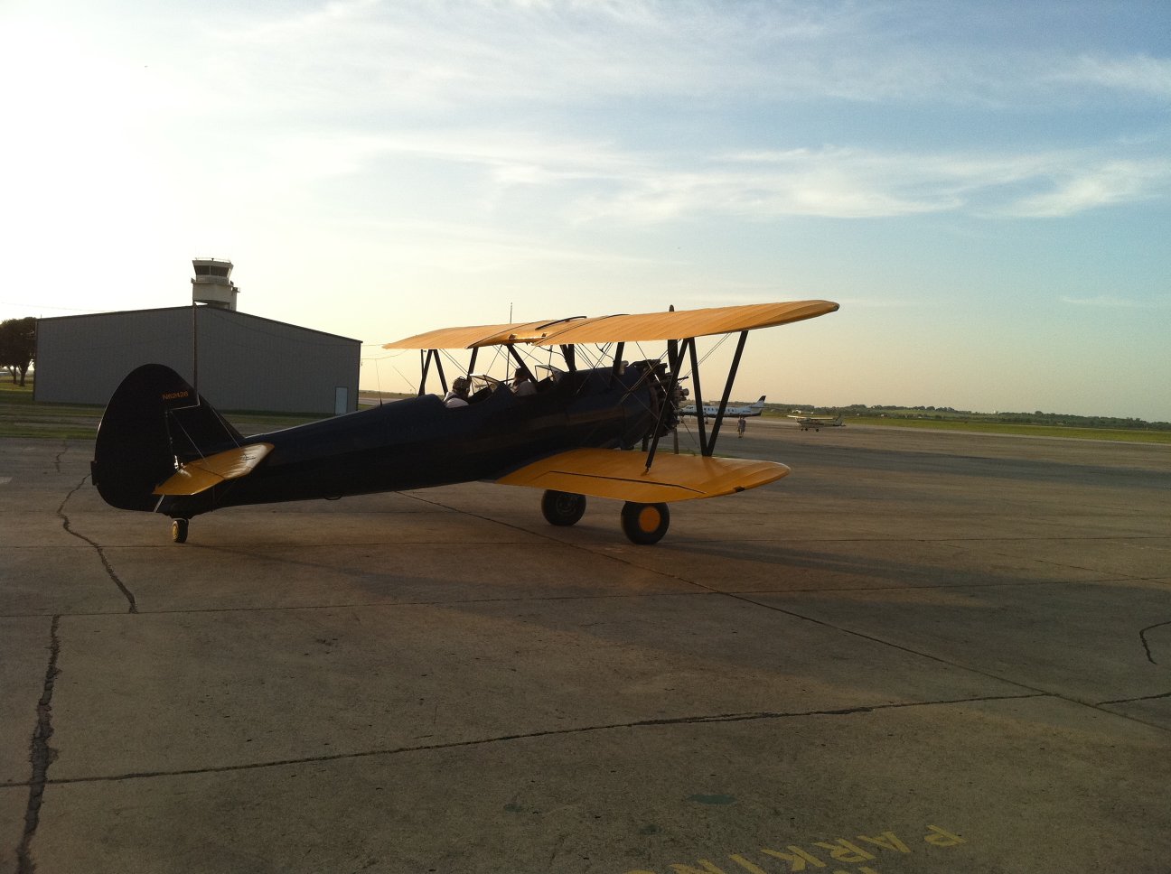

| Subject: | Re: OT Our new addition to the CAF hanger! |
Kelly, is Clint Epley still with the CAF there in San Marcos? He and my brother
are old Navy buddies...
