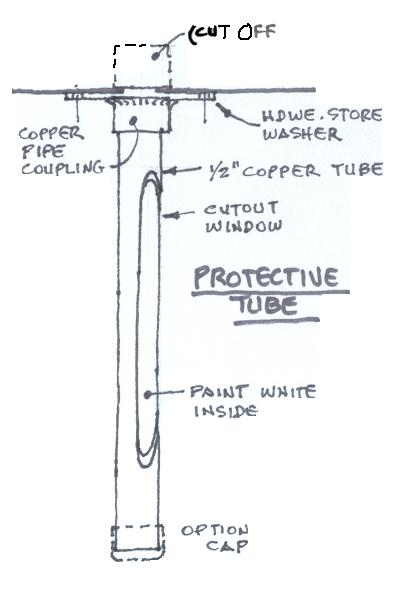

Has anyone flying used a cork/rod type gauge successfully in their center
section tank? Was wondering if you can see it while strapped in.
Jack

Message 10
I have been using just such a gauge now for 5 years and I find it to be qui
te satisfactory. I would however suggest using a small tube in the gas cap
to keep the rod from leaning over as mine does all the time.
Someday I'm going to change that and fix it. I did measure and paint the en
d of the rod white to indicate when I am running low on fuel. I gave myself
a few extra gallons before total empty. just to be on the safe side.You ma
y want more.Just paint lower for more fuel at the end.

I think Jack T meant a Cub-type gauge with the wire sticking out of the fue
l
cap, on the top of the wing tank.
I think Bill Rewey may have done that with his, and I think Kevin has that
setup on his Piet. Isn't that what the Hello Kitty mirror is for, Kevin? :
Ryan
