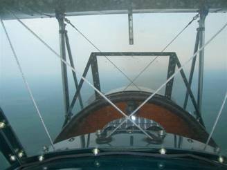

      Jack - I use the wire float gage.  I have a small mirror in the cockpit on a lanyard
      (hello kitty - kids go nuts for it).  I fly by time so I don't usually use
      the mirror, but, I do use it to make sure the gas cap is on before I take off
      after refuel.  I also use it to make sure I've got gas if I'm giving rides
      and am not keeping track of time.
      I drilled a hole in the cap and epoxied in a brass male-to-male hose connector
      from the hardware store to serve as a guide for the wire gage, thus avoiding the
      floppy-wire-problem.

      I drilled a hole in the cap and run the float wire through that.

      Gary - Forgot to mention in my e-mail: if the tank's full and the runway's bumpy
      the fuel will spew a bit out the float guide during the ground roll.  If the
      ground's smooth or the tank's not completely full it doesn't happen.
      I don't think there's siphoning due to pressure differential.  The fit between
      the float guide and the wire is pretty tight.  There's not a lot of room for liquid
      to get sucked out.

      Or you could put the sight glass out the bottom of the tank,,, Easy to see.   This
      one is similar to mine.
      Dan Plett
      http://forums.matronics.com/viewtopic.php?p=309796#309796
      http://forums.matronics.com//files/fuel_gauge_164.jpg
