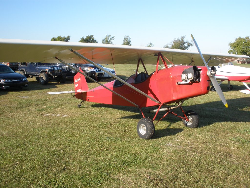

Since Dan brought it up, I'll provide what details I can on Roger White's airplane.
I have been hesitant on offering this info, but I spoke to him Friday night
and he said he wouldn't mind me posting some information here.
Roger completed "Precious Pete" in 1996. While it's not an exact Pietenpol reproduction,
it apparently flies real good according to those who have flown it
and it looks neat. If I remember correctly, he has a long steel tube fuse, metal
empennage, a single point wing attach (rather than the pair of cabanes shown
in the plans), steel gear and a Continental A-65 with metal prop for power.
I don't know much more on the specifics other than I think he was asking $15,000.
That may be negotiable, not sure what he would take.
For those that don't know Roger White... he is a master homebuilder (EAA #41) with
several aircraft to his credit and a super nice guy. He has built several
types, such as the Wittman Tailwind, Cassut Racer and a Glassair to name a few...
he is currently working on a Corvair powered Bolkow Junior.
Jim Ballew is a good friend of Roger's that lives on the same field... he also
frequents the boards here. Perhaps he can offer more details or clarification.

No, no. That's not the one I was talking about. That looks more like a Piet than
the one I'm talking about - Roger's plane looks pretty nice, actually. I like
the cowling and the combing is the smoothest I've ever seen.
Dan Yocum
yocum137@gmail.com
"I fly because it releases my mind from the tyranny of petty things."
