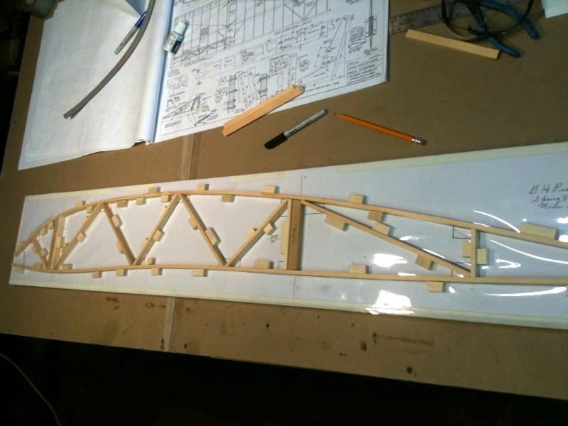

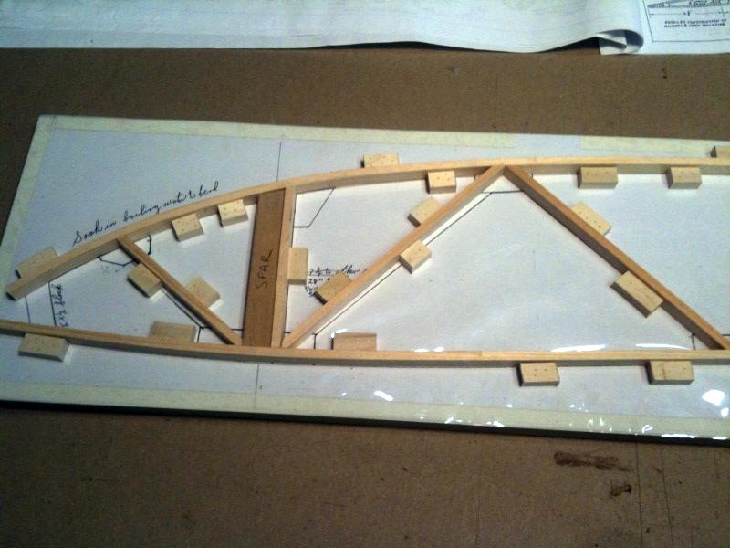

| Subject:  | Started my rib jig today |
      Used a pneumatic headless pinner for the blocks so it went together fairly quickly.
      I'm fairly sure I'm going to staple the gussets instead of just clamping
      so I can try to bang the ribs out fairly quickly.
      Attached are some photos - does everything look correct?
      I'm open to any suggestions from you guys on how to improve the jig and the rib
      building process. Thanks.
      Jamie

| Subject:  | Re: Started my rib jig today |
      Jamie:
      Looks good to me and very close to how I did mine.  Note that the two spar
      spacers you have will be very easy to glue to your ribs unless your put
      something between the spar spacer and the sticks to be glued.  I tried
      small pieces of waxed paper which worked OK but had to be replaced each
      time as they would rip when you pulled the glued up spar out of the jig
      (after the glue cured of course.)  I found that coating the spar spacer at
      the joints with a light coat of Vaseline kept the glue from sticking and
      made removal from the jig a lot simpler.  Your milage may vary.
      Jamie its looking=C2- good; get building ribs.
      My two cents...  If I were building a new rib jig today I think it would be the
      612 rib.  I would also drill two holes in both vertical upright braces that are
      next to the wing spars.  Instead of nailing the ribs to the spar through the
      top capstrip as shown in the plans, many builders nail the uprights to the spar.
      I used a picture frame nailer to squeeze the nails into the spar.
      Hope you enjoy building your ribs.

      Good work Jamie, the only thing I did different was add round cams cut from
      1" dowels when several of you outside blocks are, made it easier to insert
      and remove parts (and finished ribs). The dowels are drilled off center and
      held down with short desk screws.
      > quickly. I'm fairly sure I'm going to staple the gussets instead of just
      > clamping so I can try to bang the ribs out fairly quickly.
      > rib building process. Thanks.
      > Jamie

        To keep from gluing my rib to my jig, I used pieces of plastic grocery
      bag, about a 2"x2" square under each joint.  After removing the rib from
      the jig the next day, the plastic will peel right off.  I'm not sure it
      would be a great idea to pull the rib out of the jig before the glue is
      cured if that's what you meant by "bang the ribs out fairly quickly"  I
      did my ribs one day at a time, and it took over a month.  It is a good
      way to see if you have the stamina to finish the project though.  I made
      a few practice ribs using cheap lumber, and they are still in use as
      wall decorations.  Have fun and enjoy the journey!
