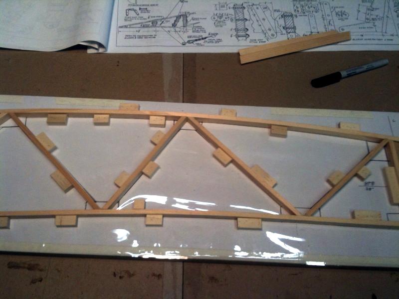

Looks good Jamie. Make sure and steam-bend your upper cap strip. I was at
your stage in July of 2000. Keep going little by little.
Dan Helsper
Poplar Grove, IL.
-----Original Message-----
From: JGriff <jgriffith19@comcast.net>
Sent: Fri, Sep 3, 2010 4:33 pm
Subject: Pietenpol-List: Started my rib jig today
Used a pneumatic headless pinner for the blocks so it went together fairly
uickly. I'm fairly sure I'm going to staple the gussets instead of just
lamping so I can try to bang the ribs out fairly quickly.
ttached are some photos - does everything look correct?
'm open to any suggestions from you guys on how to improve the jig and the
rib
uilding process. Thanks.
amie

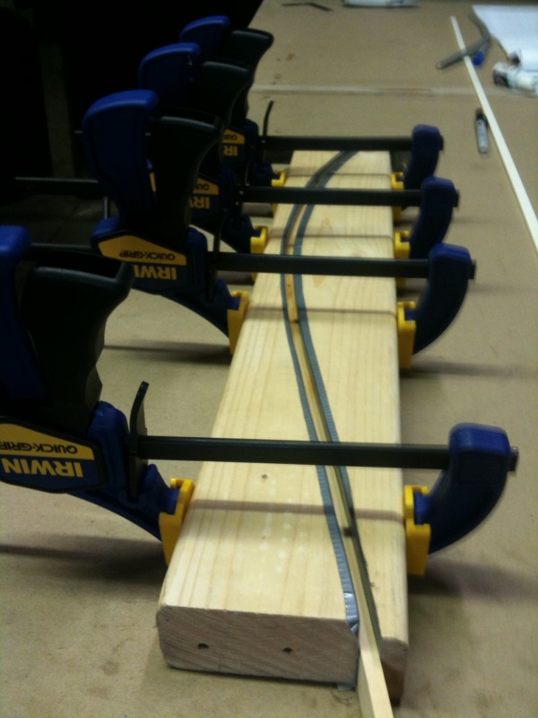

The jig has a layer of 3 mil mylar so hopefully that will be OK. I didn't think
about how to keep the epoxy from sticking to the spar spacers I have in place.
Guess I'll have to figure out a way to get some wax paper in there. I soaked
the first 15" of the top cap strip in hot water for about 20 minutes and clamped
it in my former. Seemed to work OK.
So even though I'll staple the gussets on I should wait for 24 hours or so before
removing the rib to do the other side?
Thanks for all the help and encouragement.

Just wax up the spar insert pieces (or anything else you don't want epoxy to stick
to....) real good. Epoxy won't stick to wax. You may have to do it the first
few times but after a while it will have enough wax embedded that epoxy won't
stick to it....ever. I've used paste car wax in the past for epoxy laminations
and hollow core wing molds and it worked fine. If you have a composites
products store available you can get this stuff called "mold release" which
is also just basically wax. Easier (which I like since I'm lazy) than fiddling
around with wax paper, etc.

You'll want to thoroughly clean the wax off the completed rib before gluing to
the spar. If the rib won't stick to the jig it won't stick to the spar.
I think I might have used varnish on the that spot on the jib? Don't remember.
