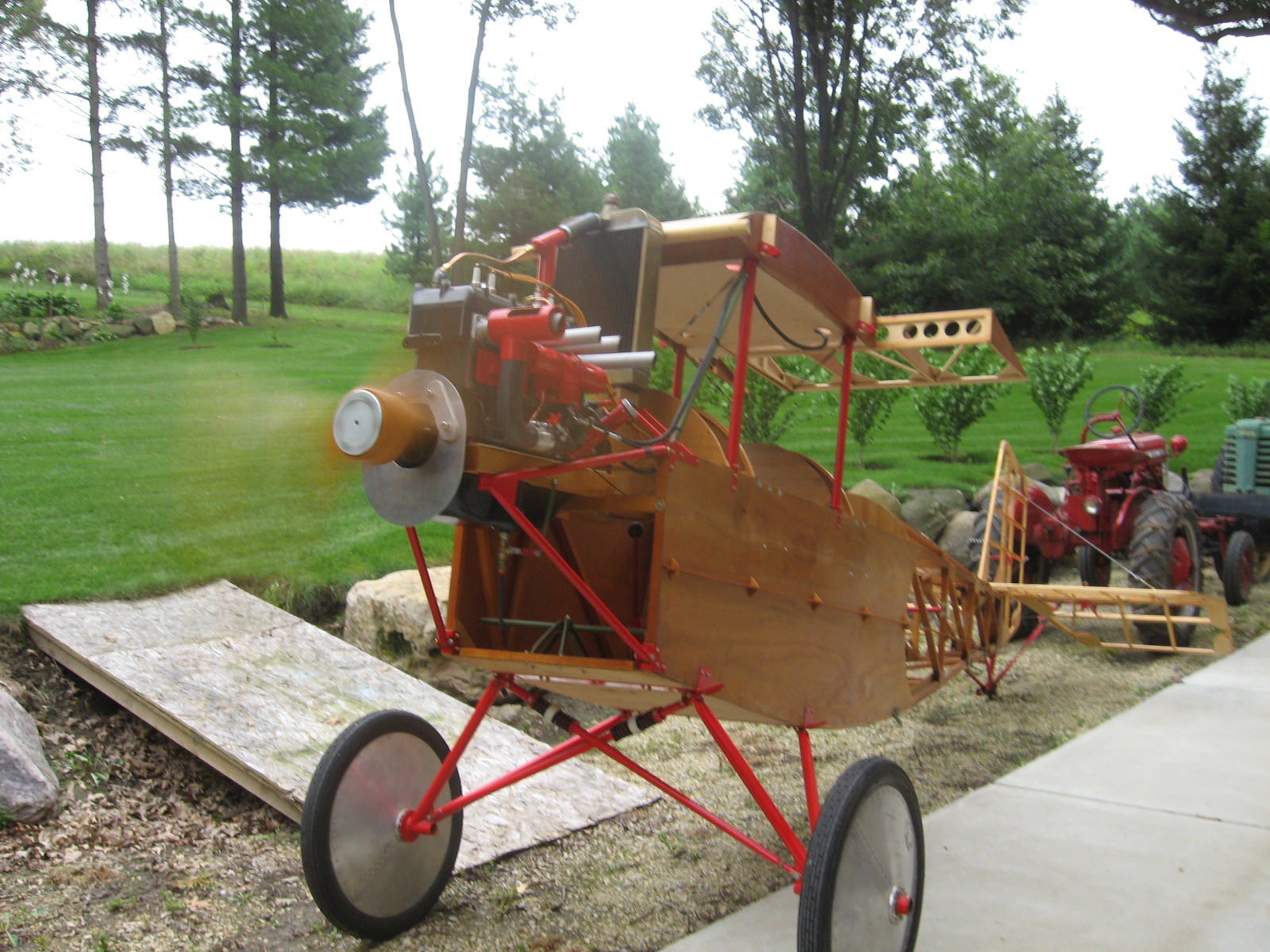

| Subject:  | Re: Color suggestions |
      Engine's gotta be black if you keep the paint scheme that you show in the picture.
      I like the green and brass, but not with that paint scheme.

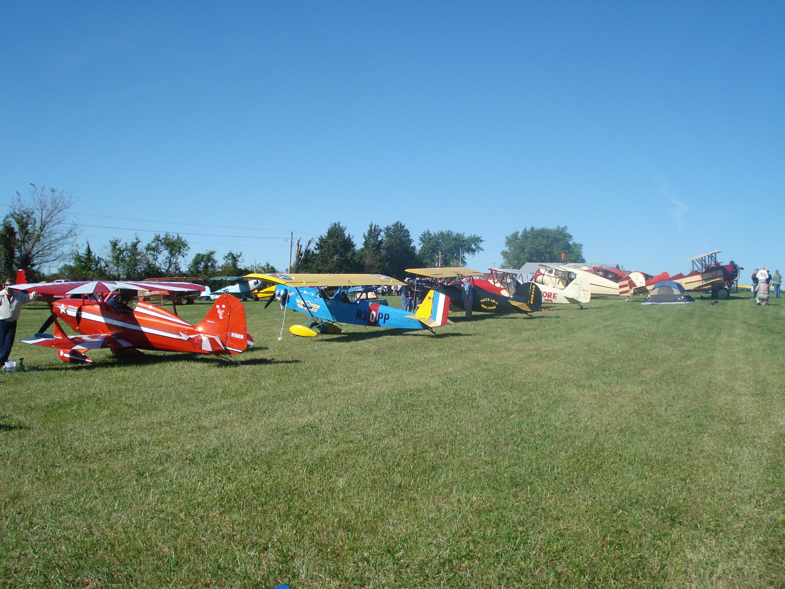

| Subject:  | Review of Blakesburg Antique Aircraft Association flyin |
      Went to Blakesburg, Iowa this year for the 4th year in a row - the big difference
      being that I actually got to fly myself there this time. I flew the GN-1 in
      on Saturday, September 4th. The weather was absolutely gorgeous! Severe clear
      with winds out of the west at about 6 mph - direct crosswind for the north/south
      grass strip.
        As I landed, I noticed there was a crowd of around 75 - 100 folks in the "peanut
      gallery" critiquing landings - which means that mine was definitely not as
      good as I'd have liked it to be - but hey - nothing got damaged...
       Taxiing to the assigned parking spot on the south east side of the field - it
      was like going down the red carpet in Hollywood - about 100 people lined the run
      and camera's were snapping. They pretty much did this to every non-spam-can
      plane that landed, but it sure made the old girl happy as she putt-putted past
      the line of Fairchilds, Curtiss Robins, Howard DGA's, Stearmans, Meyers, and
      a host of other golden oldies. Talk about a slice of heaven!
       I had probably 75-80 people stop by the plane and talk to me about it - it was
      amazing how many had actually either built a Piet, were building a Piet, thier
      grandpa/uncle/dad had build a Piet - or were thinking about building one. There
      was a ton of interest in this design.
       The old girl didn't win the dead grass award for the day - but she sure came away
      happy knowing that even though she's getting a little old - she's can still
      turn a young man's head...
      Cheers!
      Lorin
      Lorin Miller
      Waiex N81YX
      GN-1 N30PP
      http://forums.matronics.com/viewtopic.php?p=311753#311753
