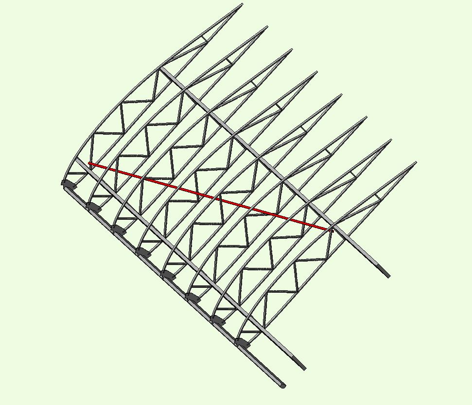

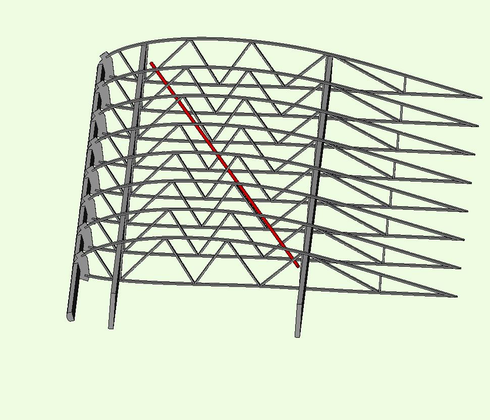

> They're not actually "attached" to the email. There are links to the
> jpegs below the word "Attachments:"
> To save you time, here are the links that he "Attached"
> http://forums.matronics.com//files/drag_layout_2_196.jpg
> http://forums.matronics.com//files/drag_layout_983.jpg
