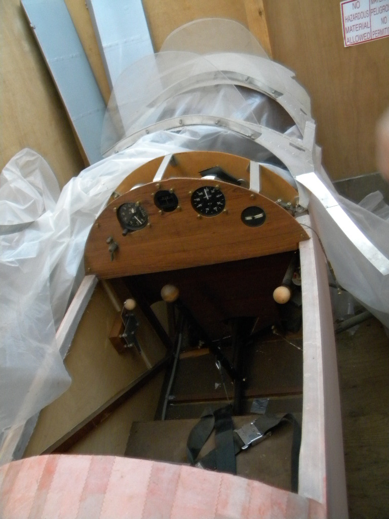

I went and looked at it today and it is pretty far along and seems well built.
Here are some photos. I'm not sure I will be able to buy the project and if anyone
else is interested I'd be happy to pass along the builder's name and contact
info via email. The project is located on the CT/RI border near Westerly RI.
http://forums.matronics.com/viewtopic.php?p=312161#312161
