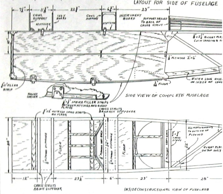

      >If one side is glued while laying flat on the table,
      >and the other side is not glued on until later,
      >there is a very high likelihood that the paneled side
      >will flex less than the non-paneled side when you join
      >the two fuselage sides. If this happens, your fuselage
      >will be out of symmetry, which would not be a good thing.
      OK, just talking theoretically here (since the topic has
      been flogged to death already), aren't the fuselage sides
      parallel from the firewall to the back of the pilot's seat,
      where the plywood ends and it's just open framing from
      there aft?  If so, then the plywood-sheeted parts aren't
      being asked to bend or flex, only open-framed sections.
      In that case, it shouldn't make any difference.
      The above does NOT apply to GN-1s or "Navratil-style"
      fully-sheeted fuselages, of course.
      Oscar Zuniga
      Air Camper NX41CC
      San Antonio, TX
      mailto: taildrags@hotmail.com
      website at http://www.flysquirrel.net

      Well, technically the fuselage sides are parallel from the firewall to the back
      of the passenger's seat, and begin tapering from there, which leaves about 29
      inches rear of the passenger seat of plywood paneled fuselage side that needs
      to flex. Now, the fuselage is only 2 inches narrower by the back of the pilot's
      seat, so not a great deal of flexing, but still possibly significant.
      Just seems like logic to me to build both sides using the same technique, and eliminate
      the possibility of unevenness.
      Bill C.

      Hi Oscar,
      My Piet sides do curve from about the rear of the front cockpit so the sides with
      plywood have to be able to be curved the same amount.
      Jim B.
