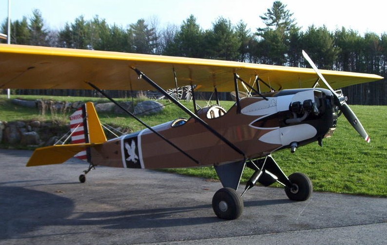

That's what the flying wires between the lift struts are for. Between them
and the roll wires on the cabanes, the wing manages to keep itself aligned
with the fuselage.

Someone else pipe up here if Im wrong, but I have no idea what would keep
the wing from twisting around the vertical axis relative to the fuselage.
With the configuration of a Piet or a GN-1 and parallel lift struts it would
appear to me that you would have to have the cross bracing. Other designs
get around this of course by the "V" configuration of the lift struts.

> That reminds me. It finally dawned on me that the GN-1 that I bought is
the only one I've ever seen w/out the cross bracing cables that crisscross
between the wing struts. The fella that I bought it from told me to keep in
mind that if a wing drops, or when you level it out after a bank, that it
"takes all she got" to get that wing up level again. He put in some quick
gap seals on the airlerons using dope/fabric, and said that it helps a
little, but he said to just be aware of it when the time comes to fly it.
The airframe does have about 480hrs on it, so it IS a proven airframe, but I
am wondering if this lack of cross bracing may be contributing to the wing
possibly warping slightly with aileron use, etc..
