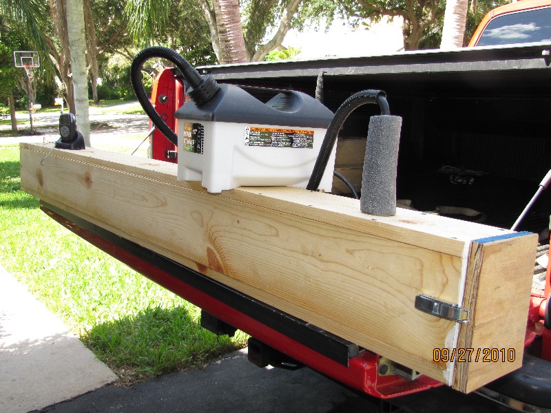

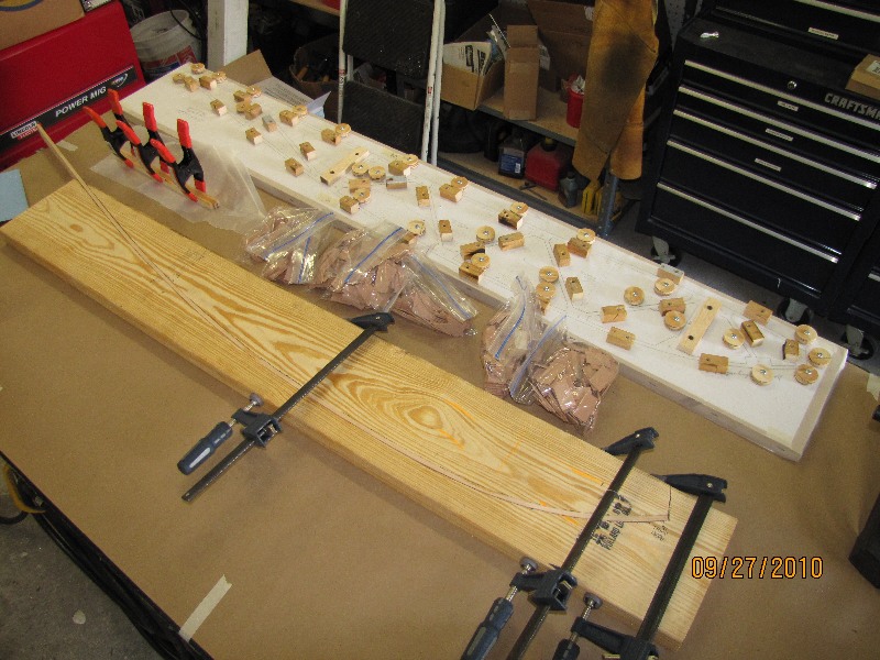

| Subject: | Startin' My Ribs- Tucker |
Well Captain and I made up the rib jig, steam box, bending jig, and cut the gussets
so I'm finally ready to make some ribs. Here are pictures of our steam box
and jigs.
Today's my birthday, I'm finally a 13 year old teenager. Whoo Hoo!
Tucker
http://forums.matronics.com/viewtopic.php?p=313889#313889
http://forums.matronics.com//files/img_0003_300.jpg
http://forums.matronics.com//files/img_0001_321.jpg

Happy Birthday Tucker! Thanks for the update on your Piet project, keep up the
good work. Hopefully you will have it done in time to solo it on your 16th birthday!

I see a few of the rib jigs are using a cam wheel to hold the top and bottom sticks
to the rib out line.
I did the same, however I installed all the cams on the inside of the rib so as
to push the sticks out against the perimeter jig blocks.
This way you are sure all the ribs will have the same outside contour line irrespective
of variations in stick thickness.
Does that make sense?
JohnW

It does make sense. However, if you put the cams on the outside
pushing in so as to have consistent location of the inside of the
upper and lower capstrips you can then cut your diagonals and uprights
en masse, since you know the distance between the capstrips on the
inside is all the same.
The minute difference in thickness of the various pieces of capstrip
material will not make a difference once they are on the wing and
covered.
With all that being said, the best method to use is the one that gets
you completed airworthy ribs the quickest!
Ryan
