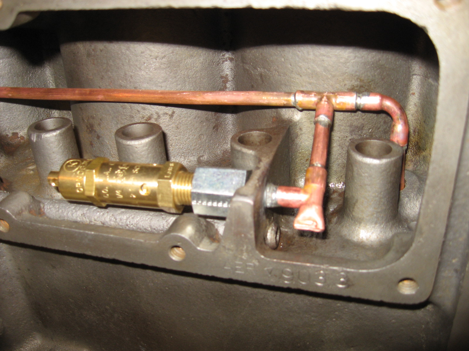

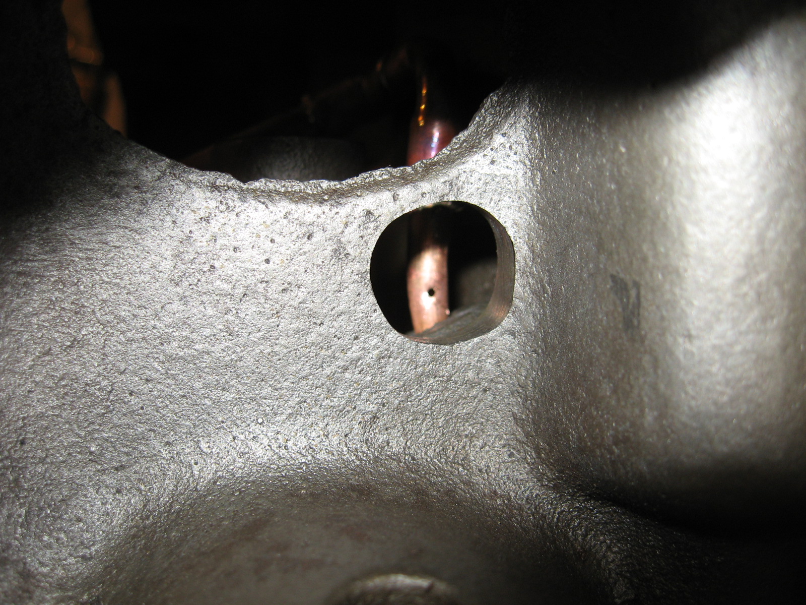

When you put the engine together did you drill the cam gear for centrifugal lubrication?
Several 1/16" diameter holes drilled from a tooth gullet inwards to
the inside lip of the cam gear face/flange allow all the oil coming off the main
to reach the gear contact area. Mine is full pressure to the mains so I drilled
a .050" hole in the capped end of the main feed tube to the front(now rear
main). I drilled the holes as suggested and have a TON of oil in tooth contact...to
the point that I somehow have oil working out of the tach connection.
Oil under pressure(30psi) sprays from this hole onto the backside of the cam gear.
Centrifugal actions carries it to the holes which then apply it to the gear
contact area.
You are welcome to stop up to Ft Atkinson anytime to look at what I did and compare
notes.
PAPA MIKE

-----Original Message-----
From: 899PM <rockriverrifle@hotmail.com>
Sent: Thu, Sep 30, 2010 2:27 pm
Subject: Pietenpol-List: Re: BIG problems- Model A wth dual mags
Dan,
l
ubrication? Several 1/16" diameter holes drilled from a tooth gullet inwar
ds to
main
lled
ontact...to the point that I somehow have oil working out of the tach
onnection. Oil under pressure(30psi) sprays from this hole onto the backsi
de of
he cam gear. Centrifugal actions carries it to the holes which then apply
it to
d
ompare notes.
APA MIKE
