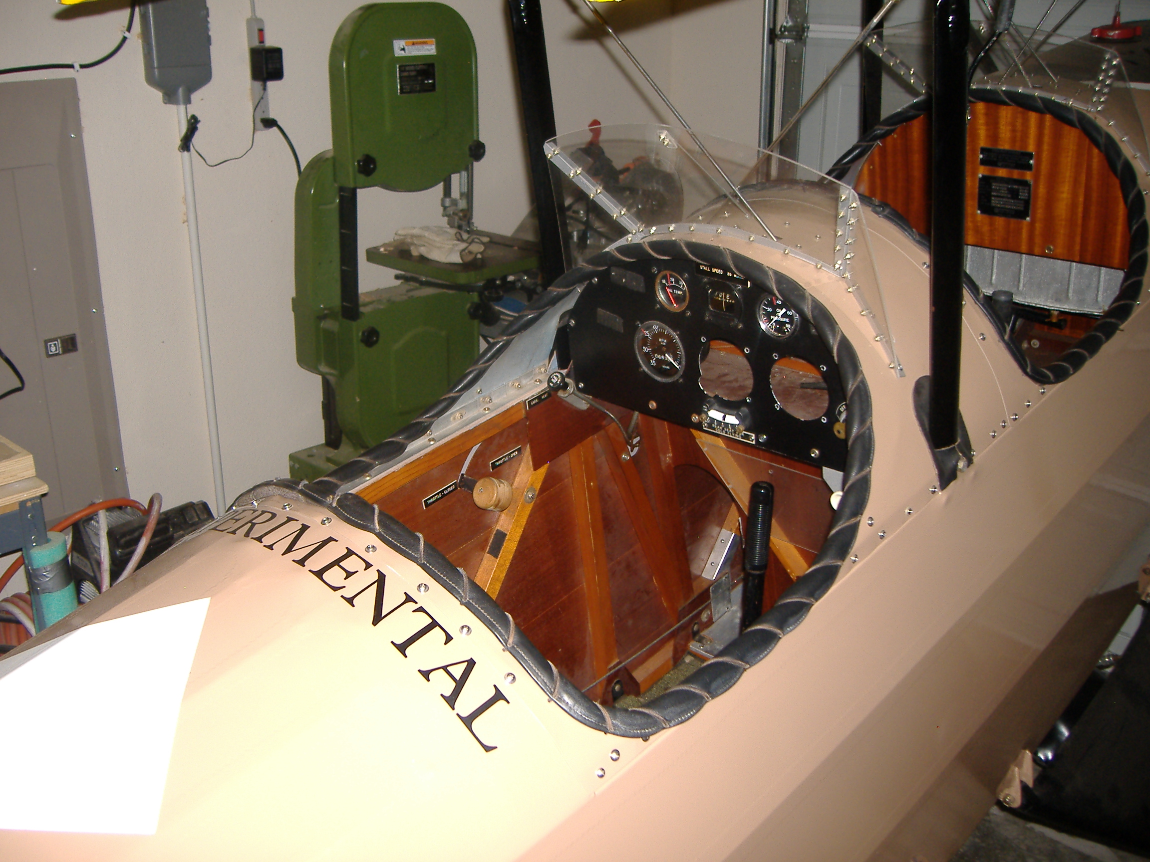

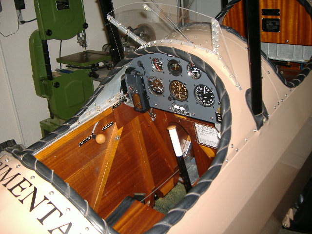

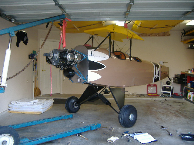

      Just looking at the photo of the Piet that Charlie attached (I assume that is the
      plane that you're restoring, Charlie), and noticed the unusual landing gear
      configuration. The thing that caught my eye initially was how squat the landing
      gear looks, and only later noticed the different arrangement. Almost like a
      straight axle split gear.
      Bill C.

Message 5
      Hi Larry,
      Glad to hear you got your airplane. Congratulations!  So far I have put in about
      500 hours labor on the Piet.  The engine also needed to be overhauled and I
      will have it finished in the next couple of days, so hope to have it in the air
      in the next couple of weeks.
      The landing gear question....I think the guy that original builder tried to modify
      a cub style gear to put on the airplane.  It is much wider than any other
      Piet I have seen and with the extra bracing definitely weighs more.  I will see
      how it does, but will probably change it back to the original gear.
      The bigger problem is the tail.  The vertical stab/rudder are over 6 ft. tall!
      Early in the Piet's life, it was ground looped in a 19 knot xwind and the owner
      blamed the small tail.  I think it will probably be one of the first things
      to be rebuilt.  Also, I think most Piets weigh in at about 650lbs. empty.  This
      one is 825lbs.  Not sure where all the extra weight came from, but I will reweigh
      it after putting the Continental 65 back on the airplane.
      As a side note:   I found out from some old newsletters that Pietenpol afficianodos
      are sometimes referred to as "Peeps".  As it turns out, my wife's favorite
      candy is the easter marshmallow chicken (Peep).  Since the airplane is painted
      with Army colors, I decided it needed some nose art. I have had the Peep chicken
      redrawn with goggles, a scarf, and leather flying helmet and the logo changed
      to "Piep" hence the name.  Once the nose art is installed, I will post a
      picture.
      Thanks again to everyone for their help and suggestions.
      Charlie
      http://forums.matronics.com/viewtopic.php?p=314408#314408
