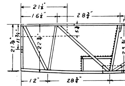

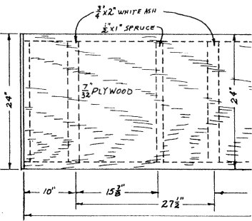

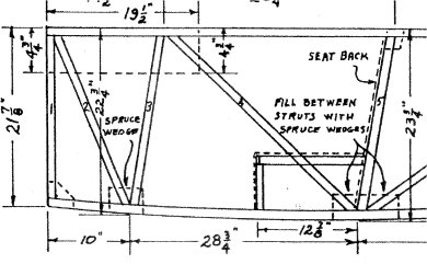

| Subject: | Fuselage - Long vs Standard |
I've got my fuse sides completed and all dimensions are per the long fuse plans
except for the angle of the rear seat back and the following diagonal brace...
I moved the top from 31" to 34" (+3"). Currently, both sides are set up parallel
and square so that I can start installing the cross braces from front to
back. I've got a few pieces cut, but before I commit to gluing them into place
I would like to confirm a couple of dimensions...
The white ash cross struts... according to the standard fuse plans, the measurements
to the center of these cross struts are 10" and 37.5" from the firewall
(as illustrated in image 2). This indicates that the front cross strut is installed
directly between the junction of side braces 2 and 3, and the rear cross
strut is installed just ahead of the junction of side braces 4, 5 and 6, correct?
If so, then I must need to transfer this thinking over to the long fuse plans,
which do not illustrate the placement of any of the cross struts. I assume that
I must use the 12" measurement from the firewall since that is where side braces
2 and 3 meet (see image 3) and the rear strut would keep the same 27.5"
measurement from the front strut (39.5" from firewall), in order to jive with
the landing gear measurements.
In short, it looks to me like the landing gear is shifted two inches towards the
rear for the long fuse, correct?
Mark Chouinard
Wings, Center Section and Empannage framed up - Working on Fuselage
http://forums.matronics.com/viewtopic.php?p=314938#314938
http://forums.matronics.com//files/standard1_188.jpg
http://forums.matronics.com//files/standard2_162.jpg
http://forums.matronics.com//files/long1_151.jpg

Message 11
| Subject: | Re: Fuselage - Long vs Standard |
Mark
What you want is 28-3/4 inches between the center of the two ash pieces. This
will keep your wing struts parallel. Install the front one between braces 2 and
3 like you said and then measure back to get the location of the other ash
piece. On my long fuselage this occurs about the middle of the front seat and
where the joint comes together.
http://www.westcoastpiet.com/images/Wood%20Gear%20Construction/IMG_1683.JPG
http://www.westcoastpiet.com/images/Wood%20Gear%20Construction/IMG_1684.JPG
In the picture you can see I had to add a piece to the back of the ash brace already
installed, I believe when I originally installed the ash cross brace I
followed the 27-1/2 inch measurements on the plans.
Chris
Chris
Sacramento, CA
WestCoastPiet.com

Message 12
Actually the long fueselage moves the firewall 2" forward, and the ash cross
members stay in the same position at the bottom of the Vs where the landing
gear attaches.
rick
> plans except for the angle of the rear seat back and the following diagonal
> brace... I moved the top from 31" to 34" (+3"). Currently, both sides are
> set up parallel and square so that I can start installing the cross braces
> from front to back. I've got a few pieces cut, but before I commit to
> gluing them into place I would like to confirm a couple of dimensions...
> measurements to the center of these cross struts are 10" and 37.5" from the
> firewall (as illustrated in image 2). This indicates that the front cross
> strut is installed directly between the junction of side braces 2 and 3, and
> the rear cross strut is installed just ahead of the junction of side braces
> plans, which do not illustrate the placement of any of the cross struts. I
> assume that I must use the 12" measurement from the firewall since that is
> where side braces 2 and 3 meet (see image 3) and the rear strut would keep
> the same 27.5" measurement from the front strut (39.5" from firewall), in
> order to jive with the landing gear measurements.
> towards the rear for the long fuse, correct?
> Mark Chouinard
Rick Holland
Castle Rock, Colorado
"Logic is a wreath of pretty flowers, that smell bad"

Message 14
Great! That makes perfect sense. That is what I'll be looking at tonight.
Thanks!
Catdesigns wrote:
> Mark
and 3 like you said and then measure back to get the location of the other ash
already installed, I believe when I originally installed the ash cross brace
I followed the 27-1/2 inch measurements on the plans.
> Chris
Mark Chouinard
http://forums.matronics.com/viewtopic.php?p=314950#314950
