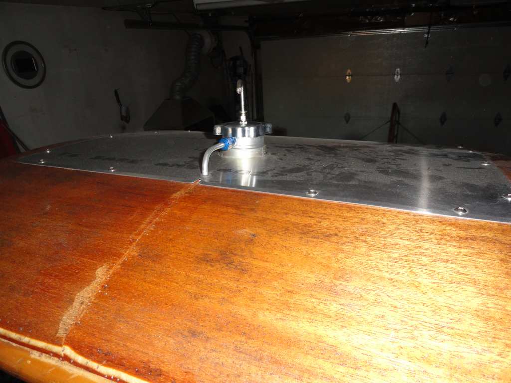

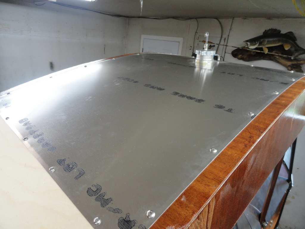

Adrian,
I didn't even think of rivet nuts - wish I had since had take off one edge of the
tee to get them to fit in the capstrip butted up against the ply.
Do you have pictures of how you handle leading edge of the panel? Is it just flat
against the wing leading edge? Are you concerned at all about water getting
into the wing?
Dan
Dan Yocum
yocum137@gmail.com
"I fly because it releases my mind from the tyranny of petty things."
On Oct 15, 2010, at 7:08 AM, pineymb <airltd@mts.net> wrote:
> Just a suggestion but what I did was use 8/32 rivet nuts (knurled type) which
pulled and seated very nicely in the thin ply. Might be easier than installing
T-nuts. This also allows the aluminum cover to be made smaller leaving space
for the gap seals.
> Screws along the leading and trailing edge are #8 x 1/2 stainless sheet metal
screws fasten directly into the spars.
> Adrian M
> Winnipeg, MB
> Canada
> http://forums.matronics.com/viewtopic.php?p=315804#315804
> http://forums.matronics.com//files/dsc00055_784.jpg
> http://forums.matronics.com//files/dsc00053_766.jpg

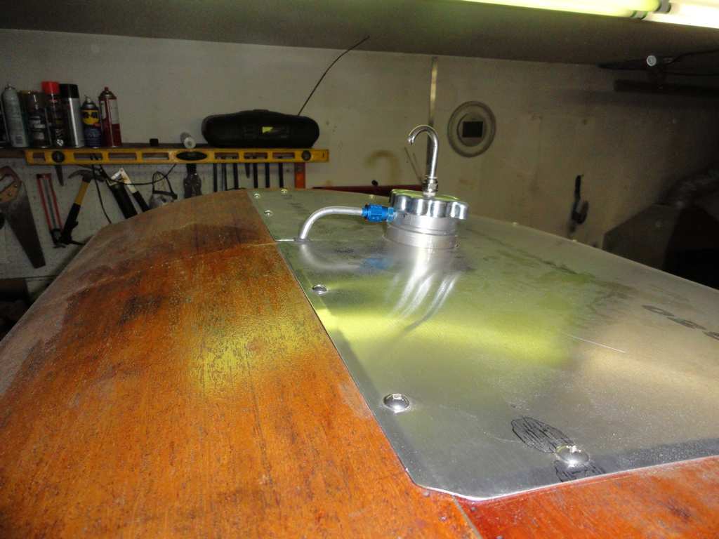

Dan
What I did was put a slight kink on all edges which makes for a wrinkle free and
fairly snug fit. Should be no problems with water especially in static mode.
I suppose one could put a very thin gasket material all around if moisture was
a concern.
Adrian M
Winnipeg, MB
Canada
http://forums.matronics.com/viewtopic.php?p=316043#316043
