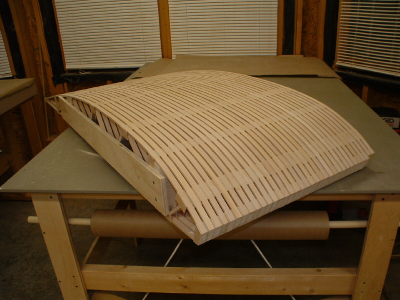

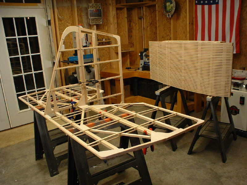

Beautiful work but you should clean that shop :)
Jack Textor
On Oct 24, 2010, at 7:34 PM, "cjborsuk" <cjborsuk@yahoo.com> wrote:
> Just completed tail parts - ribs complete. See attached pics. I left off a couple
of the gussets to be able to get the hardware installed. Is this necessary?
What are the more popular options for the hinges?
> Also, I was in Lowe's looking at varnish. What are the better options here? Has
anyone used water based varnish?
> Thanks,
> Chuck
> http://forums.matronics.com/viewtopic.php?p=316905#316905
> http://forums.matronics.com//files/completed_ribs_771.jpg
> http://forums.matronics.com//files/tail_and_ribs_204.jpg

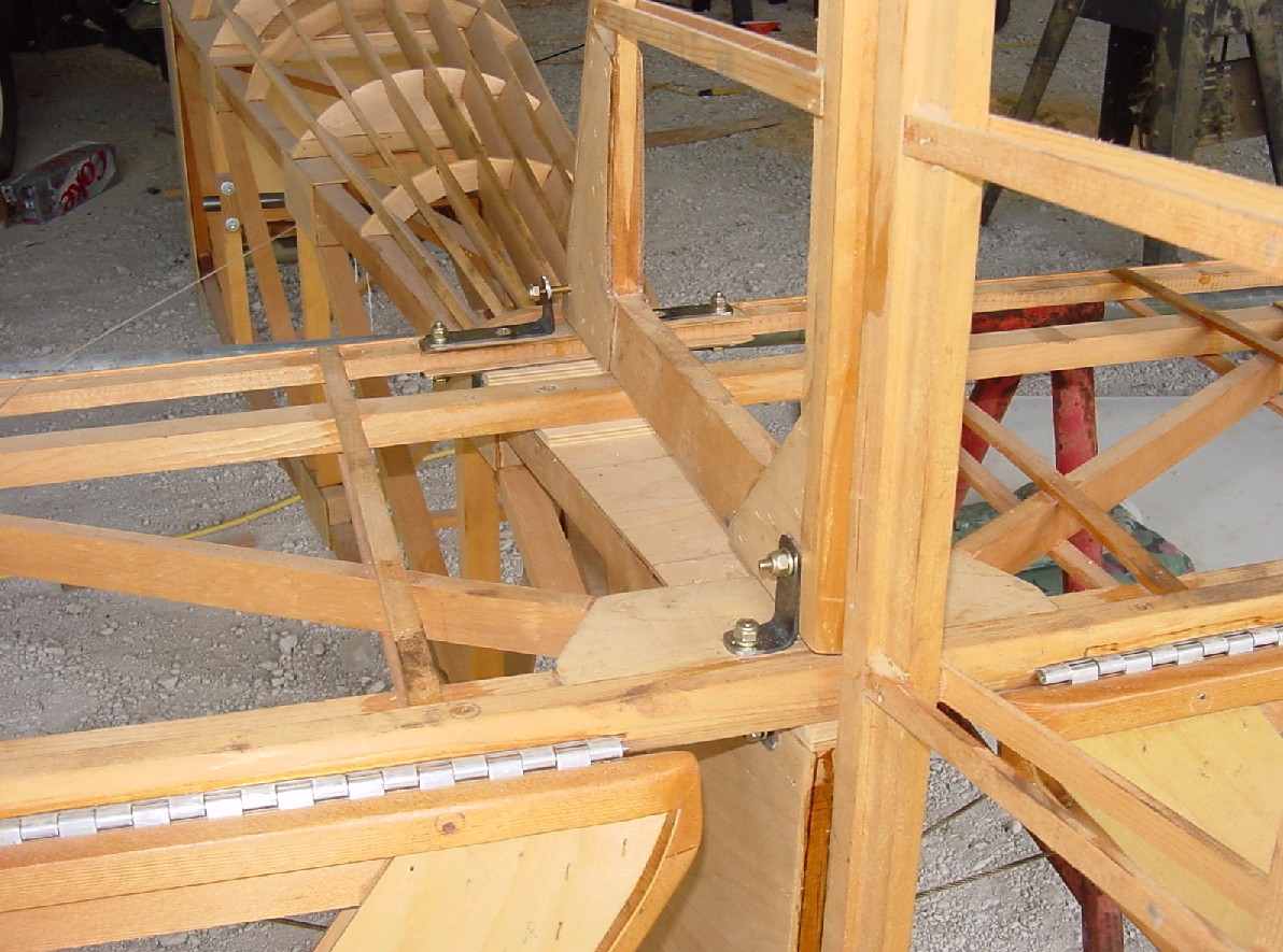

I noticed that it appears in your picture, that the edges of the tail surfaces
are not shaped. It appears that the leading and trailing edges are flat. I am
curious if you plan on leaving them this way, or plan on shaping them later? (Or
is my eyesight going...?)
Attached are some pictures on the way I did my hinges. (Explained in HINT Video
#3 Tail).
I am using Minwax water based spar varnish. Which at this point, I was only able
to buy off of the web.
Your work looks very nice!

Michael, What size piano hinge is that?- That is a nice neat way of hingi
ng the tail, Just watch out for cracks in the aluminum hinge segments.- D
ad used the Vi Kaplar cast hinges, they work good but after 250+ hrs are st
arting to get a little bit of play in them, due to the steel clevis pin wea
ring out the aluminum hinge.- And as far as shaping the leading and trail
ing edges, that is a "Must Do", from a cosmetic standpoint, it can really d
etract from an otherwise good looking airplane, when left square.
Just my 2 cents,
Shad
=0A=0A=0A
Message 5
The hinge is the largest AS&S sells in the extruded variety. The open span
is 2" and the thickness is .052...I believe. I cut my tail hinges at 2" lon
g each and have the typical set of 3 for each control surface.- As you no
ted, I will be watching the hinges closely for wear/cracks. I totally agree
with the shaping of the wood...I was hoping the builder just had not got t
o doing them yet.
Michael Perez
=0AKaretaker Aero
=0Awww.karetakeraero.com

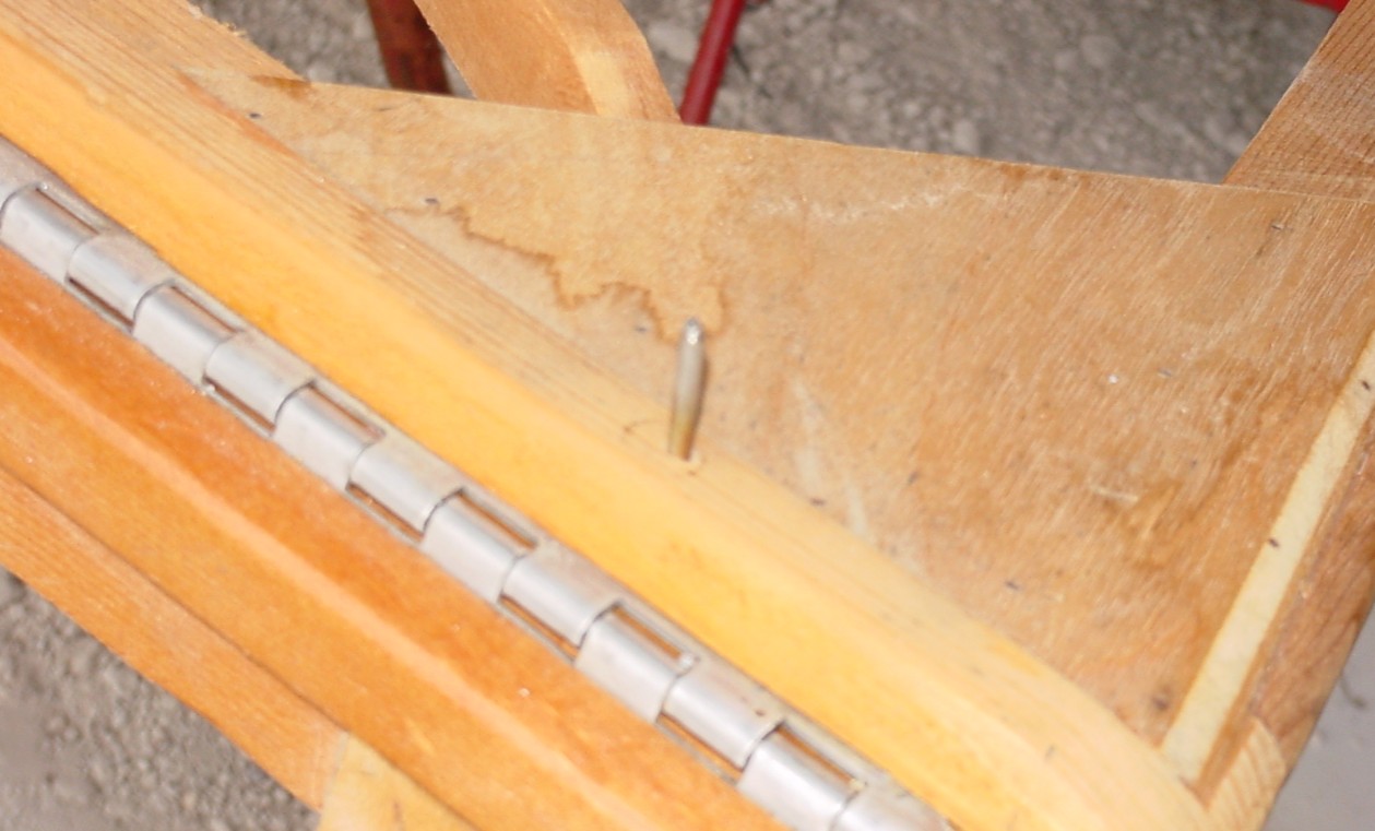

Shad,
I cut a groove 1/16 wide X 3/4 deep and epoxied the aluminum hinge in the groove.
Then I put 1/8 stainless pins vertical for insurance against the epoxy turning
loose. Thus I have full length hinges that will double as gap seals. I
made the edges where the hinges go 1/2 wider so cutting the groove didn't weaken
the structure. I think it would have been fine without it though. I will cross
drill the hinge on each end to retain the hinge pin with little 1/16 cotter
pins.

I was currious, the short hinge segments in the photo were a little concern
ing to me.- The full span hinge will be plenty strong.- Using safty wir
e to hold the hinge pin in would be ok to, if you can't find small enough c
otterpins.
Shad
