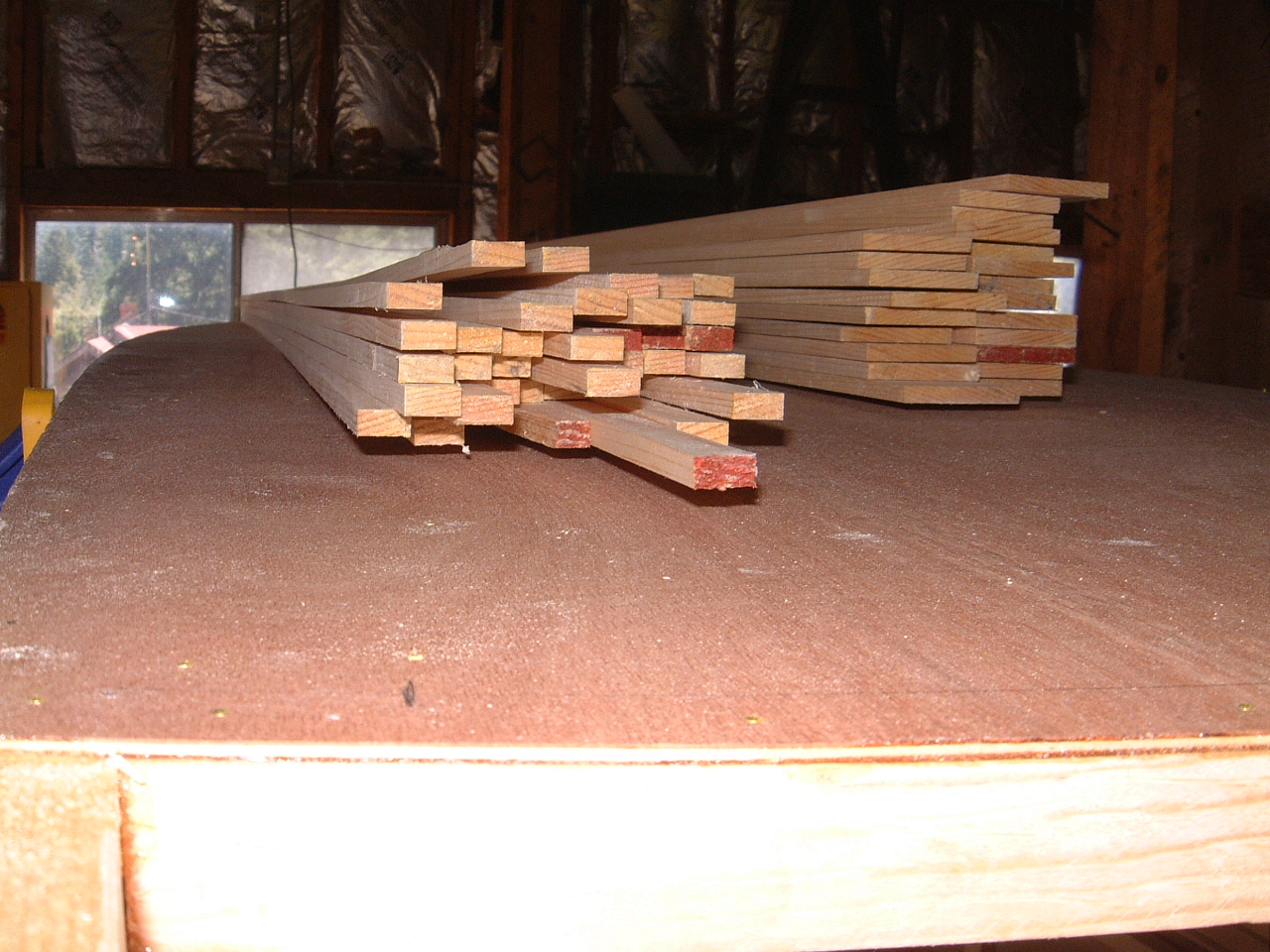

Hi,I cut all my capstrips and milled them.Takes 86 to do the 3 piece wing.I used
1 1/2- 2"x9"x6' rough cut sitka.You loose about half the wood and it takes about
4 hours.Make sure you have the grain laying correctly for a capstrip.
Building a Piet
http://forums.matronics.com/viewtopic.php?p=317063#317063

Message 3
| Subject: | Re: Resaw Options |
What is the correct grain orientation for capstrip?
John

Hi,The grain should run as shown in the picture.The compresive strength is
that way.That is how it is shown in the old CAA and FAA books,Runs just like your
spar.Your wing needs compresive strength.I have seen it run the other way and
it cracks along the grain lines and the ribs can split.Hope this helps.Dave
Building a Piet
http://forums.matronics.com/viewtopic.php?p=317142#317142
