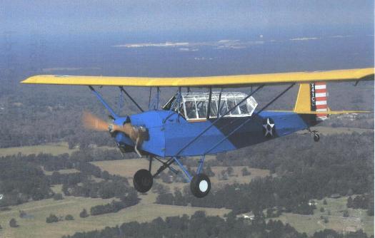

I'm already ahead of you. I found an old SNJ canopy and fitted it to 41CC. (I
guess I should mention that I did it with paper, scissors, and glue though ;o)
Oscar Zuniga
San Antonio, TX
Air Camper NX41CC
http://forums.matronics.com/viewtopic.php?p=317393#317393

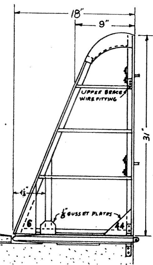

hi everybody-
i have my horizontal stab. jigged up and ready to start gluing but
noticed that when i take what will be the bottom of the fin and lay
it on the hor. stab. that it only sits on the main beam gusset and the
3/16 ply doubler on the spar- it's not touching the leading edge
doubler.
Is that normal or have i screwed something up!?
Thanks-
Earl
Earl Brown
I may not have gone where I intended to go, but I think I have ended up where I
intended to be.
http://forums.matronics.com/viewtopic.php?p=317394#317394

Hmmm, seems that the base of the vertical stab should be that same as the chord
of the horizontal stab... 18". I don't have my parts in front of me, but that
is the way the plans show it to be.
Is your Horizontal stab 18" from LE to TE? If so, how long is the base of your
vertical stab? Are you accounting for the thickness of the vertical TE and LE?
Those should be attached to the front and rear of the base material. Have
another look at the image below for clarification.
Let us know what you discover.
Mark Chouinard
Wings, Center Section and Empannage framed up - Working on Fuselage
http://forums.matronics.com/viewtopic.php?p=317405#317405

Thanks Mark;
Yep, everything is the right size, but, giving your picture the alice's restaurant
treatment (and actually just noticing it myself) the arrows are pointing
to the gaps i'm talking about.
i am thinking i could add a small piece to the bottom to the vert. stab.
to fill in upper gap at the leading edge.
Earl
Earl Brown
intended to be.
http://forums.matronics.com/viewtopic.php?p=317407#317407

Ahhh, ok... I see what you are talking about. Yes, mine is the same way (with
the slight gap). I misread your original post... I thought you were saying that
the base of your vert stab was short...
Mark Chouinard
http://forums.matronics.com/viewtopic.php?p=317409#317409

Ray,
You sneaky devil! You're really making progress.
I don't know the answer to your question, but attached is living proof that
the Piet still flies with plywood covering! Dick has an advantage of plenty
of engine weight & horsepower.
Gary Boothe

| Subject: | Hor. Stab. Question |
You may not have gone where you intended to go...
Doublers need to be added at several points on the horizontal stabilizer in
order to make things come out right.
See below:
Jack Phillips
NX899JP
Raleigh, NC
-----Original Message-----
[mailto:owner-pietenpol-list-server@matronics.com] On Behalf Of echobravo4
Sent: Friday, October 29, 2010 9:12 AM
Subject: Pietenpol-List: Hor. Stab. Question
hi everybody-
doubler.
Thanks-
Earl
Earl Brown
where I intended to be.

Gary,
I have not been working on the Sky Scout for all summer, but am about to
start in again. Unfortunately, my wife has me painting the kitchen,
pantry and back porch...before I can play!
I think I saw that Piet at OSH this year, or last; but did not remember
it. I will be using the re-built A65 on the Sky Scout. It is lighter
than the Camper and carries only one person, so maybe there is some
margin there for some weight extravagance. Looks like Dick used 1/8" on
the sides, maybe on the top, too? Is the tail section covered in wood?
Maybe it is just a great paint job. Is his plane featured in the West
Coast Piets? I well check.
Thanks. I am following all your comments and pictures on your plane....
great job!
Ray Krause

Ray,
You sneaky devil! Youre really making progress
I dont know the answer to your question, but attached is living proof that the
Piet still flies with plywood covering! Dick has an advantage of plenty of engine
weight & horsepower
Gary Boothe
Cool, Ca.
