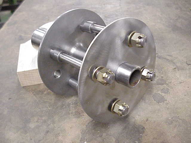

Jeff,
The crank flange on the Model A is small, too small to bolt a prop to and e
xpect it to stay on and stay tracking properly. I bought a prop hub that Ke
n Perkins sells that fits the Continental 6-bolt spacing and crush plates t
hat are available from him or ACS. Said hub, attaches on to the Model A cra
nk flange with four cap screws. I used blue Locktite to insure those cap sc
rews stay in there, because there is not enough room to fit a nut behind th
e crank flange. You can see the stuff that Perkins sells if you go to Mykit
plane.com and look him up. His current email is KenandVernaperkins@sbcgloba
l.net
Any other questions let me know.

I've seen the hubs that Ken makes.. they look great..but the 4 bolt hub he makes
is like the one Mr Pietenpol used... four bolts, well four studs..that hold
the T hub to the crank flange with 7/16 bolts right into the original holes...
so the diameter is the same as the crank flange
Dan your prop does not have a hole in the middle.. one of the things i was thinking..
was the original idea with the T hub to center the prop on the shaft with
the wood turned spacer
here is Ken's 4 bolt hub
jeff
