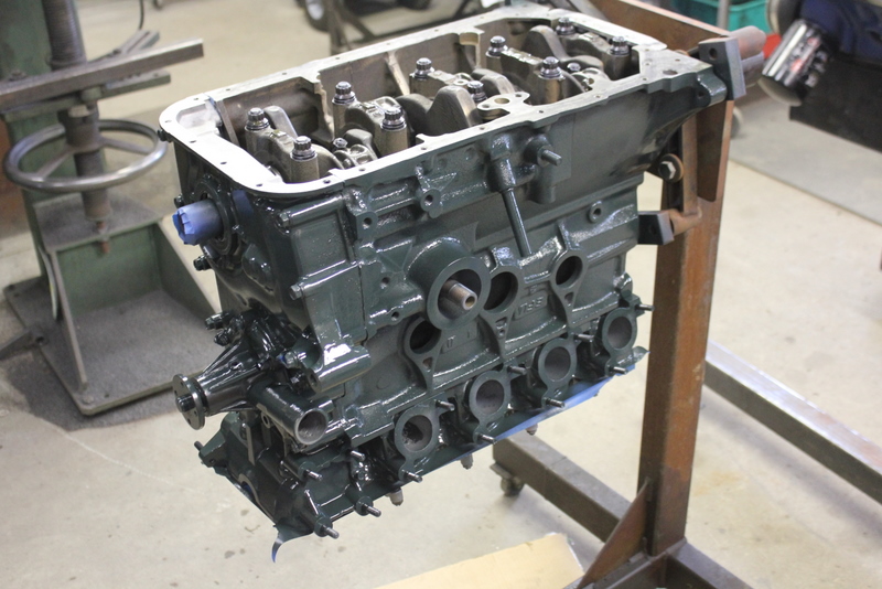

| Subject: | Mitsubishi Engine ready to get installed... |
Just finished rebuilding the mits engine, going back to the Dyno one more time,
then on the airframe for tests with the prop.
http://forums.matronics.com/viewtopic.php?p=320598#320598
http://forums.matronics.com//files/img_1219_840.jpg
http://forums.matronics.com//files/img_1218_634.jpg
http://forums.matronics.com//files/img_1217_261.jpg
http://forums.matronics.com//files/img_1216_596.jpg
http://forums.matronics.com//files/img_1215_863.jpg

| Subject: | Re: Mitsubishi Engine ready to get installed... |
Hey Chris
Are you building this with a reduction drive? Seems like a saw a photo from
Broadhead with a reduction drive on it.
Ken
it will have a bearing housing that is not installed yet......i will post more
pictures as i finish putting on all of the accessories. I plan on video taping
the dyno runs, i will post links to those also.
http://forums.matronics.com/viewtopic.php?p=320609#320609

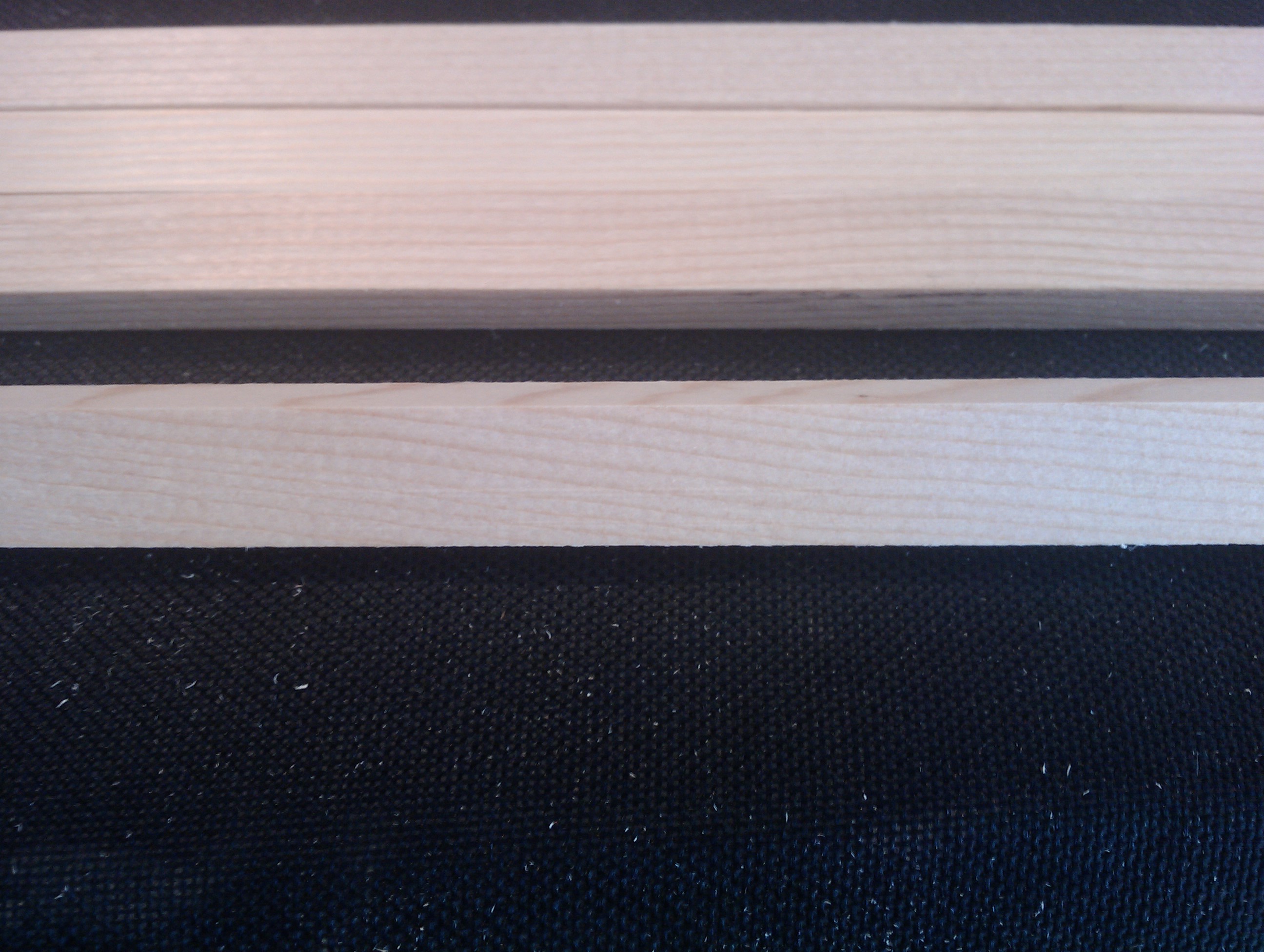

Message 24
| Subject: | Rib capstrip grain runout |
Hi
I've read numerous comments on ribs being over built. Some of my capstris have
up to 1:6 grain runout. Are the ribs stout enough I can use this up in the webbing
or do I need to cull this out? (see attached photo.
thanks
Kim
"She is about as hot as you'll ever find a plane and I'll bet that 10 years
from now the design will be pretty warm still." B. H. Pietenpol
http://forums.matronics.com/viewtopic.php?p=320634#320634
http://forums.matronics.com//files/img_20101123_110408_434.jpg

Message 27
| Subject: | Re: Rib capstrip grain runout |
Personally, I'd use the top ones and cull the bottom one based on the photo.
Hopefully the A&Ps and IAs will weigh in.
Kevin "Axel" Purtee
NX899KP
Austin/Georgetown, TX
http://forums.matronics.com/viewtopic.php?p=320636#320636

I agree with Kevin. You may be able to use parts of that strip with
less runout for the cross braces, though.
Ben
On 11/23/2010 2:37 PM, kevinpurtee wrote:
> --> Pietenpol-List message posted by: "kevinpurtee"<kevin.purtee@us.army.mil>
> Kevin"Axel" Purtee
> NX899KP
Message 39
Appreciate the advice. I guess that's why I joined the list
> Ben
photo.
>> Kevin"Axel" Purtee
>> NX899KP
Kim,
I would cull them ALL out, send them to Jack Textor, Des Moines and I will
use them for kindling. Seriously, the ribs are twice the size they need to
be, Use the ones you are concerned with in the webbing, to stir epoxy or
whatever. Enjoy the build!
Jack
DSM
-----Original Message-----
[mailto:owner-pietenpol-list-server@matronics.com] On Behalf Of
integritywood
Sent: Tuesday, November 23, 2010 1:29 PM
Subject: Pietenpol-List: Rib capstrip grain runout
<kim.integrity@gmail.com>
Hi
have up to 1:6 grain runout. Are the ribs stout enough I can use this up in
the webbing or do I need to cull this out? (see attached photo.
thanks
Kim
years from now the design will be pretty warm still." B. H. Pietenpol
Ha I've heard that line before
The temp was 24 below this morn so anything unusable might kindle my own
fire. Sorry Jack.Do not archive unless you feel its really important
On 2010-11-23 5:30 PM, "Jack" <jack@textors.com> wrote:
> Kim,
> Jack
> DSM
> From: owner-pietenpol-list-server@matronics.com
> integritywood
> Hi
in
> thanks
> Kim
The top three are OK Kim. The bottom one I wouldn't
use for anything longer than the runout. So four, maybe
five inches would be OK since a couple of inches will
be under the gussets. Also, you want the straightest
grain for the top capstrip as there's quite a bit of bending
stress, especially near the nose.
I know what you mean about not getting to fly. After doing
mine through Air Cadets in '60 there wasn't the money
to fly and educate so 50 years later I are again a pilot. It's
taken a lot more time to solo at 67 than it did at 17!!!
Especialy in a 100hp Citabria. Although to be fair, first
time around it was a Fleet 80 Canuck. Fully aerobatic,
cruise at 90, vne 160! I'm still surprised I actually made it
past my 18th birthday! I did manage to exceed 160 in CF-DQR,
but that's another story. :-)
http://pcmuseum.tripod.com/dc3/canuckother.htm
Clif
Some of my capstris have up to 1:6 grain runout. Are the ribs stout enough
I can use this up in the webbing or do I need to cull this out? (see
attached photo.
> thanks
> Kim
