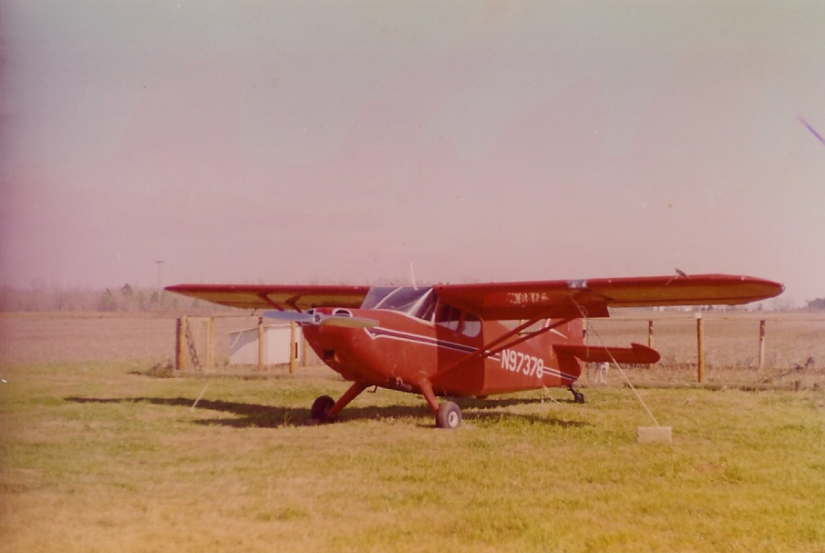

I built 1 degree into my one piece wing which amounts to the tips being 3 inches
higher than the center. The reason I did that was from an experience with a
Stinson 108 that I owned. A prior owner had shortened the struts so the wing had
ZERO dihedral. As long as you were doing air work or in the pattern it was
great. Even a short cross country was a bit aggravating because it flew like sitting
on a basketball. Look down at the Sectional, look back up and you were
turning one way or the other. The dihedral makes it a lot harder to handle on
the workbench. I hope to put it on an airplane one day !
Jerry Dotson
inches higher than the center. The reason I did that was from an experience
with a Stinson 108 that I owned. A prior owner had shortened the struts so
the wing had ZERO dihedral. As long as you were doing air work or in the
pattern it was great. Even a short cross country was a bit aggravating
because it flew like sitting on a basketball. Look down at the Sectional, look
back up and you were turning one way or the other. The dihedral makes it a
lot harder to handle on the workbench. I hope to put it on an airplane one
day !
