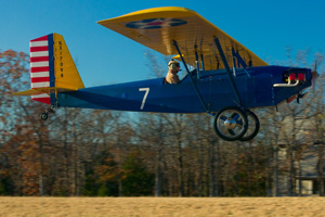

      N1709R is finally back in the air.  After 600hrs of labor and a few thousand dollars,
      the airplane flew for the first time (again) after being brought back to
      life from being neglected for the past 10 or so years.  (It is interesting to
      note the size of the giant tail.  The original builder didn't think it had enough
      rudder control, so he enlarged it to over double the normal size.  Now it
      has lots of rudder authority, but looks somewhat cartoonish in flight.  At first,
      I didn't like it, but it is growing on me (no pun intended).
      Thanks for everyone's input and help.
