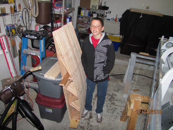

Got my ribs all done. Hooray! Now onto the fuselage. Captain says that we have
to build a mock fuselage first. I guess we'll do that when I'm out of school
for the Christmas break.

You make me proud. Keep on a keepin' on and one day you will fly your OWN
airplane. In the process you are learning things that no one can take away from
you. The skills you learn while building will pass on to adult life as a way
to get a job if you want to work with your hands. I would love to have you for
a grandson.

Good for you. Smart to get that most tedious task out of the way right up front
when you are highly motivated. Building the fuselage has bee my favorite part
so far!

Good Job Tucker!
I was glad to be done with my ribs and start on the tail.
I will be starting on the wings or the fuse after Christmas.
Keep up the good work!

Congratulations Tucker, you have accomplished a lot. Just keep at it and before
you know it you will have the makings of a real airplane.
