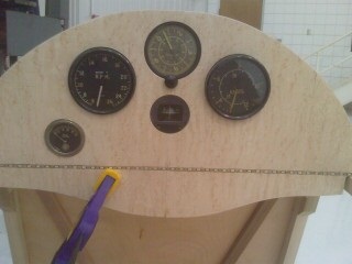

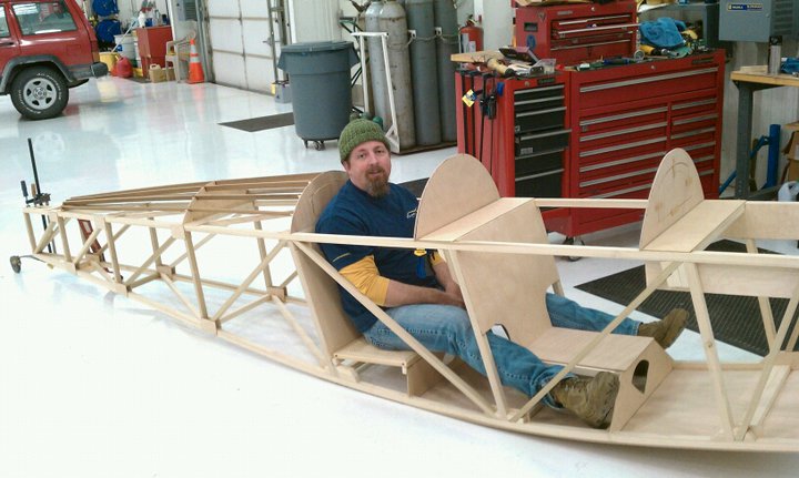

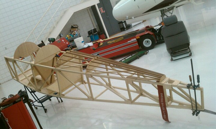

So i'm one and a half months in....i sure hope i can keep the pace
I need metal so i can start on the brackets for the gear legs..but i'm excited
to be able to sit in it and make engine noises
my wife jumped in the front seat and says it's way more room than she expected
Hey Dan.... i loved you seat so much i made my own..
jeff
ribs done
wheels on order
engine stripped ready to ship out [Wink]

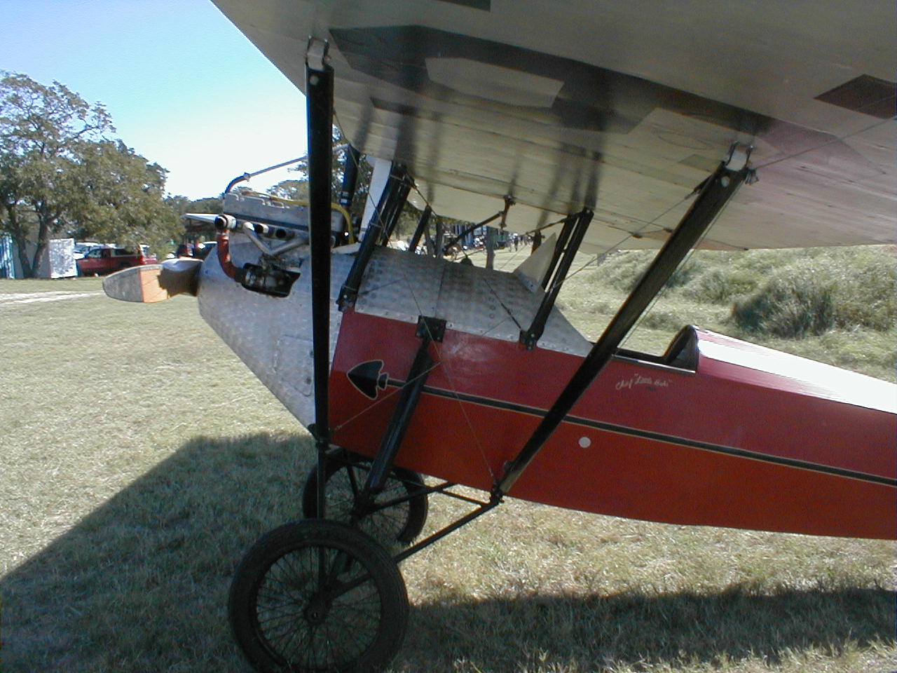

Thanks for the pics of the Sky Scout. I am also building one. Ray, we will
have to chat in the future about this one.
Dick N.

Charles, if you noticed, Jeff DID include pictures as attachments in the
bottom of the email. And the last one has a beautiful young lady sitting in
the front seat.
By the way, nice looking work, Jeff. And I'm impressed that anyone who
builds Pietenpols could attract such a nice young lady.

i'm sure she'll appreciate the compliments... that's my wife of almost 15 years..
she's 5' 10 and i was a bit worried about her fitting so i've been kinda warning
her about it being small...i'm actually building with the F&G manual....
she says she feels like is has more room than my 120 did because we're not shoulder
to shoulder..

Jeff, looks nice!, Are you an A&P?- Jusk asking because I noticed the Lec
tro Tug, and Citation in the background, and that looks like one nice hango
r to build a Piet in.

Jeff,
Very nice looking seat indeed! And the instrument panel inlay I like
too! I am impressed by your speed of construction. Brodhead 2011? :O)
excited
expected
jeff
ribs done
wheels on order
http://forums.matronics.com/viewtopic.php?p=323428#323428
http://forums.matronics.com//files/dash_188.jpg
http://forums.matronics.com//files/piet1_508.jpg
http://forums.matronics.com//files/piet4_469.jpg
http://forums.matronics.com//files/piet5_239.jpg

Why yes i am Shad...i've been in the corporate aviation world since 88..
citations, hawkers, lear and challengers most of my career .... i work on little
planes for friends..annuals and such, but only for a few that i know and trust...
thanks for the inspiration on the seat Dan.. i dig it..
and Cliff on the dash shape.. i'm not sure i would have thought of the little curve
on the bottom of the panel.. but it really fits the time period i think
jeff

Jeff !
Please ask your wife if she would like a ride in my old style Ford driven Pietenpol,
I give rides, even when I help getting the riders in. You must teach her
step up more to clear the cockpit edge.

Steam-Punk. Just like the rest of the plane. :-)
Clif
> little curve on the bottom of the panel.. but it really fits the time
> period i think
> jeff

Great looking fuse. Really, I was only looking at the fuse. Can you tell me where
you got the cane seat bottom?

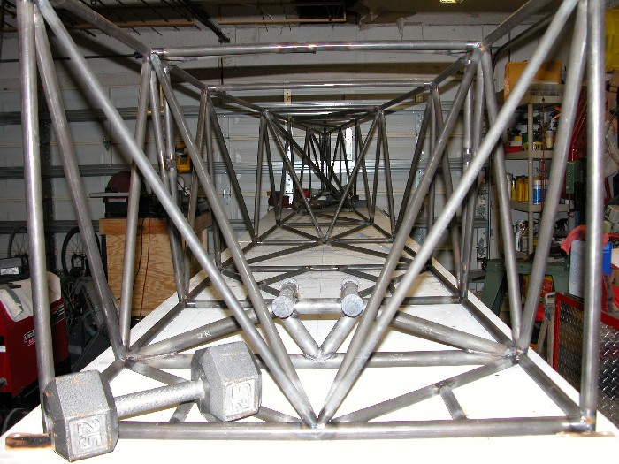

| Subject: | Re: TIG inverter welder? |
I welded my entire Skybolt using TIG. But I also needed my O/A rig for heating
some things up. TIG's the only way to go to get the best quality welds and the
least amount of warpage due to its very small heat affected zone (HAZ). With
a little bit of practice, your welds will look like a neat stack of dimes.
Very strong and pretty!
