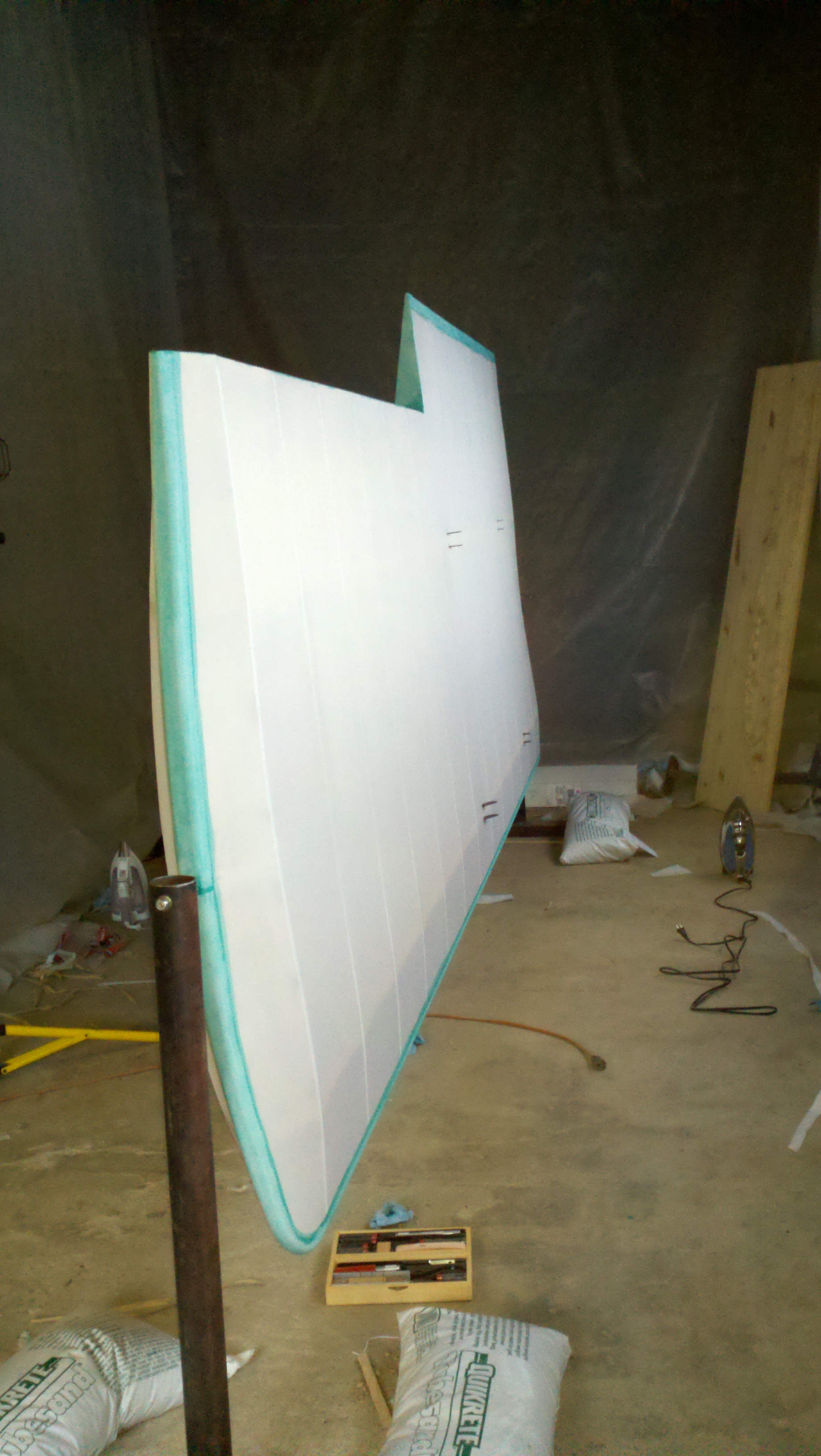

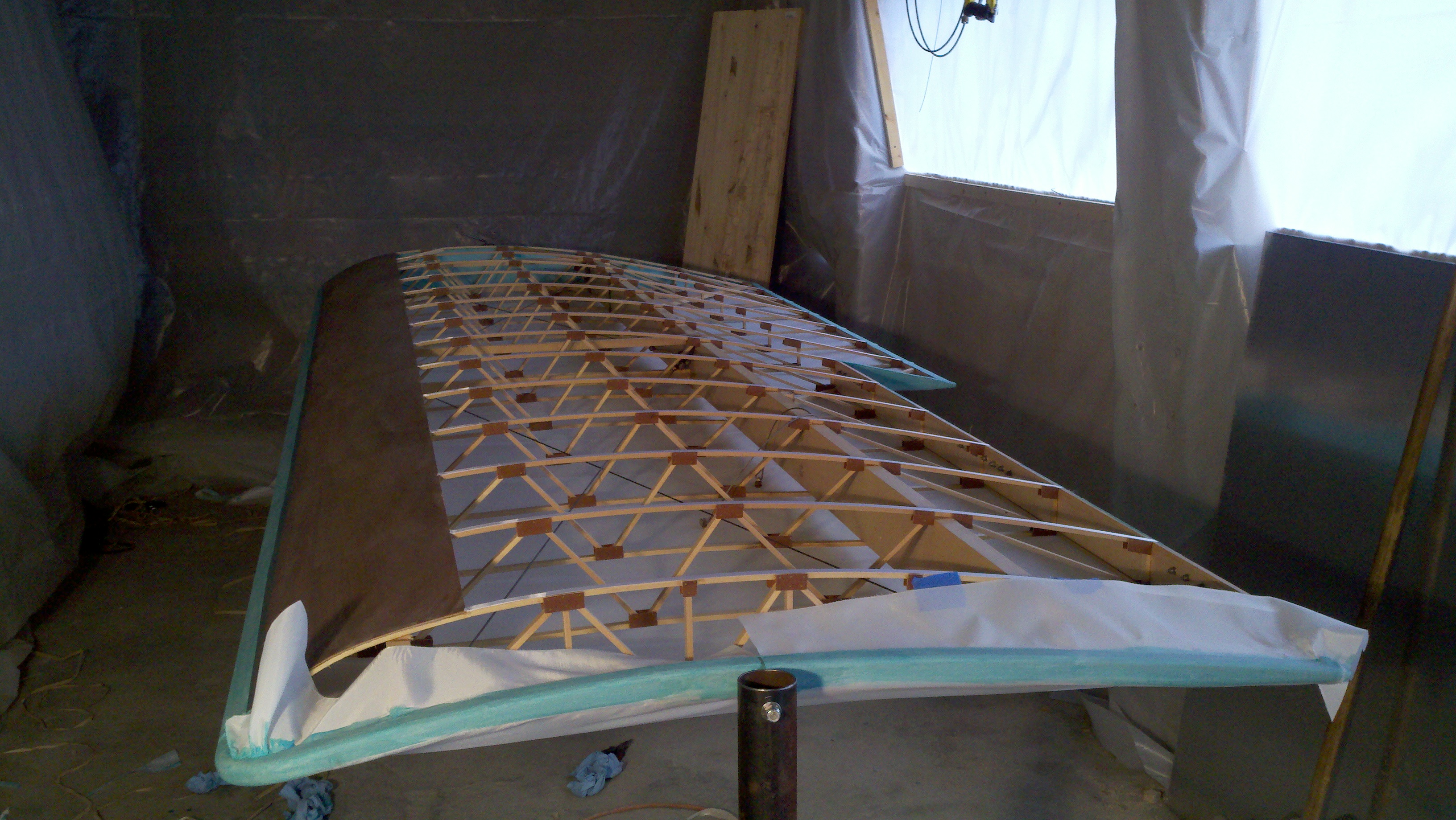

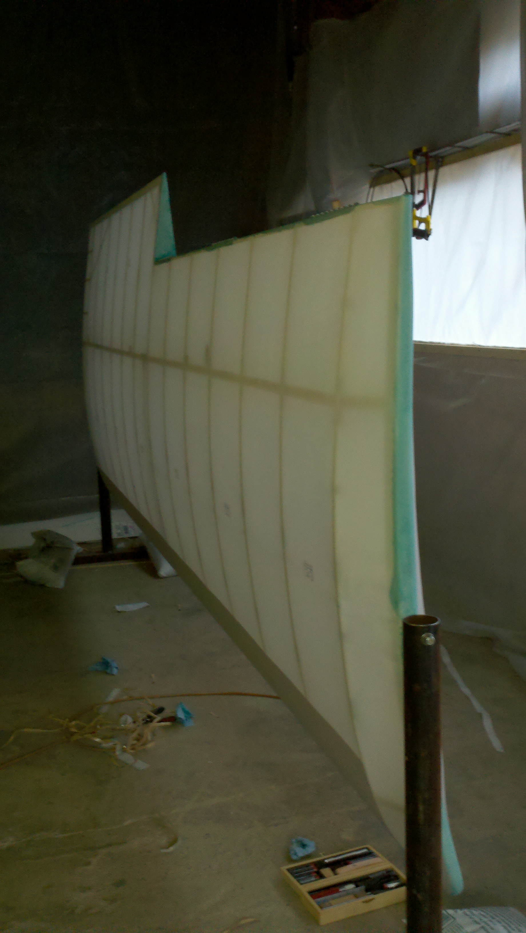

Message 14
Howdy,Covering the wings.Stewart Systems working great!dave
Covering Piet
http://forums.matronics.com/viewtopic.php?p=323856#323856
http://forums.matronics.com//files/2010_12_19_15_54_41_476_835.jpg
