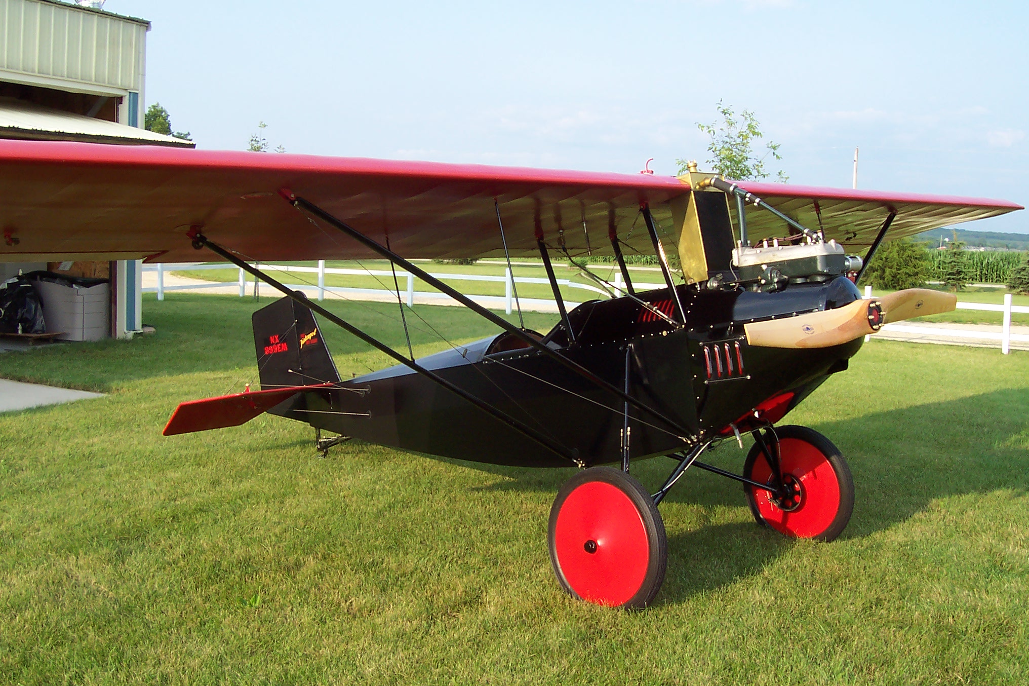

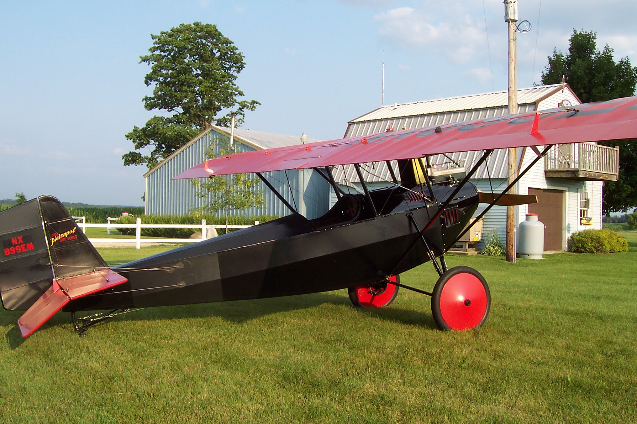

Message 37
| Subject: | Re: Sky Scout pix |
Here are a couple pix of my old Sky Scout. I bought it as a project, later sold
it to Dennis Hall (Brodhead) who finished it into one of the nicest looking planes
I have ever seen. Dennis' work was flawless!
PAPA MIKE
http://forums.matronics.com/viewtopic.php?p=324063#324063
http://forums.matronics.com//files/100_1347_480.jpg
http://forums.matronics.com//files/100_1346_610.jpg
Actually that plane was owned by Earl Myers for a while here in Louisville Ohio
and Earl had it up thru fabric
covering when it changed hands and ended up with Dennis but for sure---- Mike Cushway
was the original builder of
the start of that airplane. It did turn out very nicely !!
Earl got out of aviation completely for some reason and got into model trains and
railroading but have lost touch
with him so not sure what he is up to lately.
Mike C.

Message 40
That is one gorgeous airplane. Anyone going to Brodhead must give it a once
over...just beautiful.

Message 41
Absolutely gorgeous.

Actually, that beautiful Sky Scout that Dennis Hall completed isn't in Brodhead
anymore. It was sold, and now lives in the Port Townsend Aero Museum, in Washington,
not too far from Seattle.
http://www.ptaeromuseum.com/pietenpol.html
