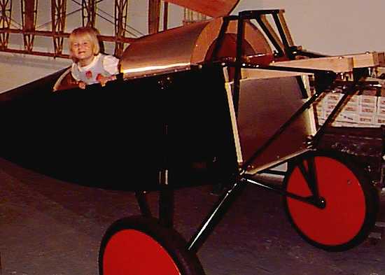

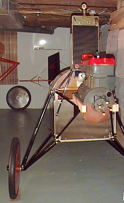

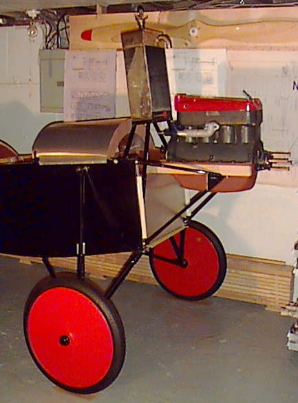

Blew some dust of these pics! These go back a ways. I wish I had gotten a chance
to fly the Scout before it migrated west.
PAPA MIKE
http://forums.matronics.com/viewtopic.php?p=324122#324122
http://forums.matronics.com//files/sseng5_843.jpg
http://forums.matronics.com//files/sseng3_399.jpg
http://forums.matronics.com//files/scoutfuse_184.jpg
http://forums.matronics.com//files/scoutcanoe_116.jpg
