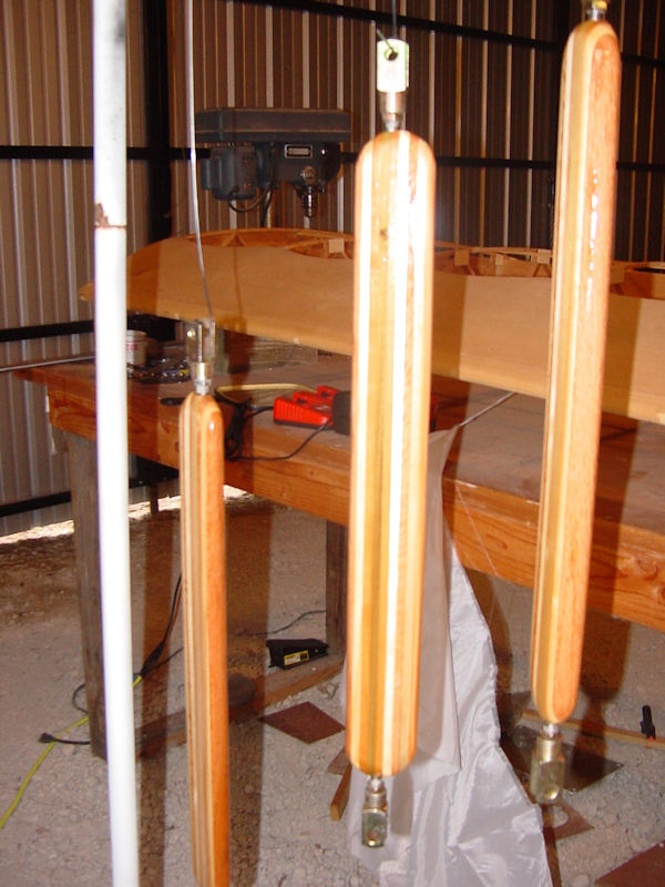

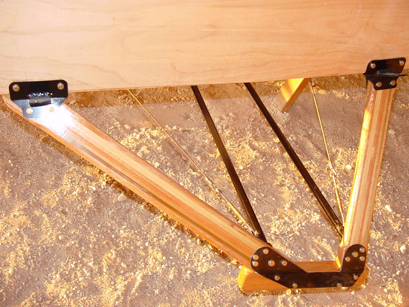

The gear on NX510JD is laminated from red oak, poplar,pecan, ash, and fir. 10---1/4
inch layers. All the struts are laminated with 9---1/4 layers with a 3/8
4130 steel rod sandwiched inside.

Hi Jerry,
What's the lamination orientation on your struts? 9 1/4 in. laminates
seems like a lot. Also, does the 3/8 inch rod carry all the way
through & attach to anything, or lust there for reinforcement? I'm
planning on wood struts with carbon fiber between the laminations.
KIp Gardner

The 3/8 rod goes all the way through. I glued up the struts 5 layers and 4 layers.
The I milled a 3/8 half round groove from end to end. Then laminated the
2 pieces around the rod with T-88. The 5 layer part will be trailing edge.
10---1/4 inch layers. All the struts are laminated with 9---1/4 layers with
a 3/8 4130 steel rod sandwiched inside.
Jerry Dotson

Ok... .i think i'm getting closer
I have the gear legs about right... but i made the lower bracket to the plans and
the angles just aren't right... but looking at the west coast site i see that
the metal was made to fit the angles of the gear...not the wood to fit the
metal.. and that makes it all look a little better.
am i wrong here ?? the fittings i made could work but the lines or the angles
don't match
so i think it goes like this... make the wood fit in the jig and to the fuselage
attach points... then make the metal fitting to hold the bottom of the gear
together..right ??
jeff :?

I made all the wood parts first and then made the metal to fit the wood.
This is one of the reasons that prefabricated metal fittings for sale to
Pietenpol builders just doesn't work. You need to make the fittings "fit"
the wooden structure.
Jack Phillips

"You need to make the fittings "fit"
the wooden structure."
Jack, I can't agree more. This is the number one tip I try to pass on to new
builders.
Chris
plans and the angles just aren't right... but looking at the west coast site
i see that the metal was made to fit the angles of the gear...not the wood
to fit the metal.. and that makes it all look a little better.
angles don't match so i think it goes like this... make the wood fit in the
jig and to the fuselage attach points... then make the metal fitting to hold
the bottom of the gear together..right ??
jeff :?
http://forums.matronics.com/viewtopic.php?p=324856#324856
Message 26
You are correct. Make the fittings fit your airplane.
Chris
Sacramento, Ca
Westcoastpiet.com
-----Original Message-----
[mailto:owner-pietenpol-list-server@matronics.com] On Behalf Of bender
Sent: Tuesday, December 28, 2010 5:02 PM
Subject: Pietenpol-List: gear fittings
--> <jfaith@solairusaviation.com>
jeff :?
